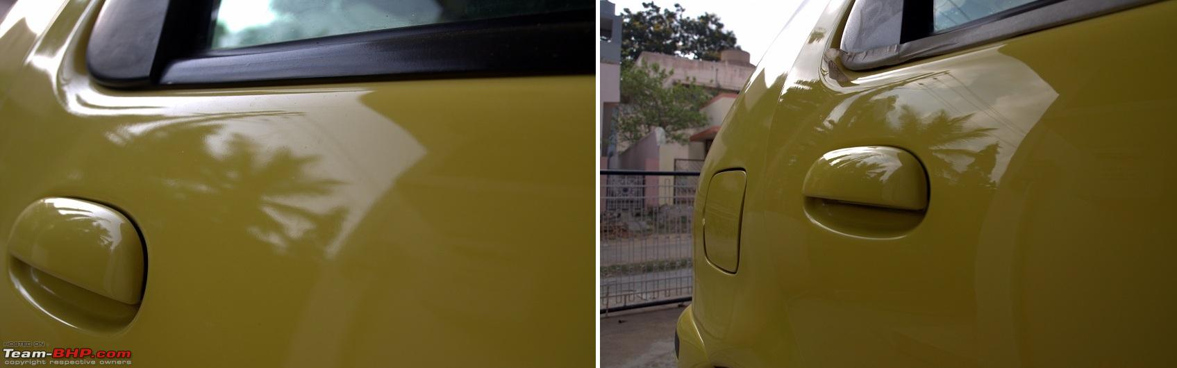

Looks great! You should have tried the denim pads, removing orange peel makes a lot of difference, an example:

Attachment 1179738
Frankly speaking, I was afraid that I might cause irreversible damage by using the denim pad with UC (the most aggressive compound I have) on speed setting 6 - as the paint quality is not up to the mark in more ways than one.

I still say you can do it. Paint is still soft since you got it recently painted and perhaps DA + Denim pad will work for you.
You're being very cautious and it is good - however my paint was far worse, and it turned out just fine!
BUT - the results will be spectacular. Below is another example from my roof :
Before :
After :
