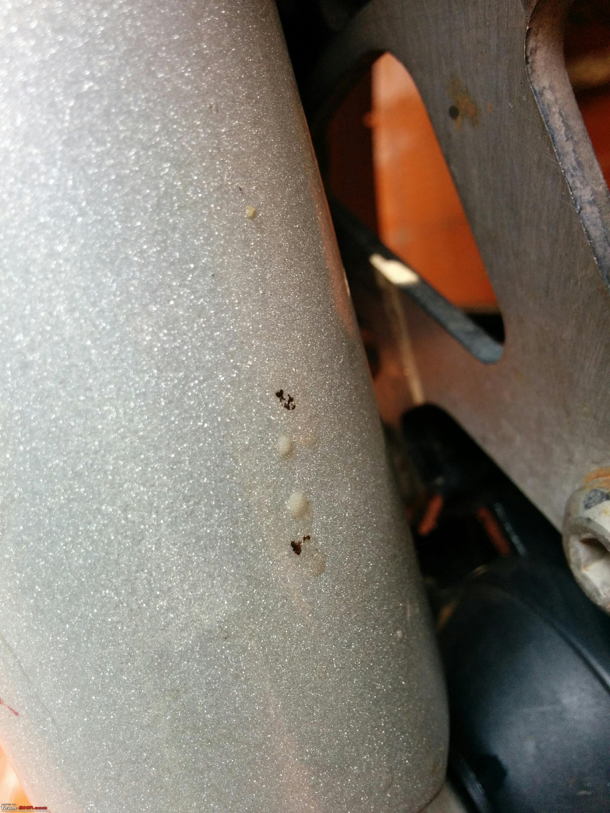

I found something similar to Turtle wax bug and tar remover. This is called Krud Kutter 3 In 1 Automotive Clean-Up, bought it off amazon. Seems to dilute tar. It is good in removing other dirt, grime as well. Good multi purpose product. Best part is no smell at all. I have been using sonax wheel cleaner. It smells like crazy.
The only problem with Krud cutter is that, the liquid seems to dry off very fast. It is not wet for the 1 min de-greasing time required for the Krud cutter. It is not too oily. More like watery stuff. So i agitate the area keep wiping off. Maybe in humid conditions, it may work even better.
Did you try using aftershave lotion (Old Spice or Axe) with high Alcohol content for this ? I do it for all the tar and bug spots on my car windshield. Going by the pic you posted, looks like its front axle of a bike next to disc brake. You can safely use alcohol 70v/v to clear spots.
Then why not IPA? Pure alcohol, or dilute it yourself as you require.
One problem with sticky stuff is that, when softened, it just spreads. Does alcohol prevent this? I had to get chewing gum off my car (spat by a biker who did not like what I called him!) and, after spreading it around a bit, which was not good, I found that WD40 prevented this and worked perfectly.
In the event of non availability or easy access After Shaves are a great solution. I suggested for Old Spice cause it leaves less or very light residue behind. Some brands have Aloe, which leaves behind sticky layer which can be wiped off without any issue.
> 70v/v alcohol prevents the spreading issue. Its similar to trying to wash ink pen drop using water. Dilutes and runs. I tried on my car alloy and soaked it with IPA dabbed on a cotton ball. The problem with WD40 was the sticky residue that I noticed. Hence I stopped using WD40 for such work. For tar residue I try to first scrap with a sharp screwdriver and then use alcohol.
Bubblegum is a monster. I usually remove it using cooking oil soaking method. My friend uses Olive oil and says it soaks much better and bubblegum just loosens itself.
