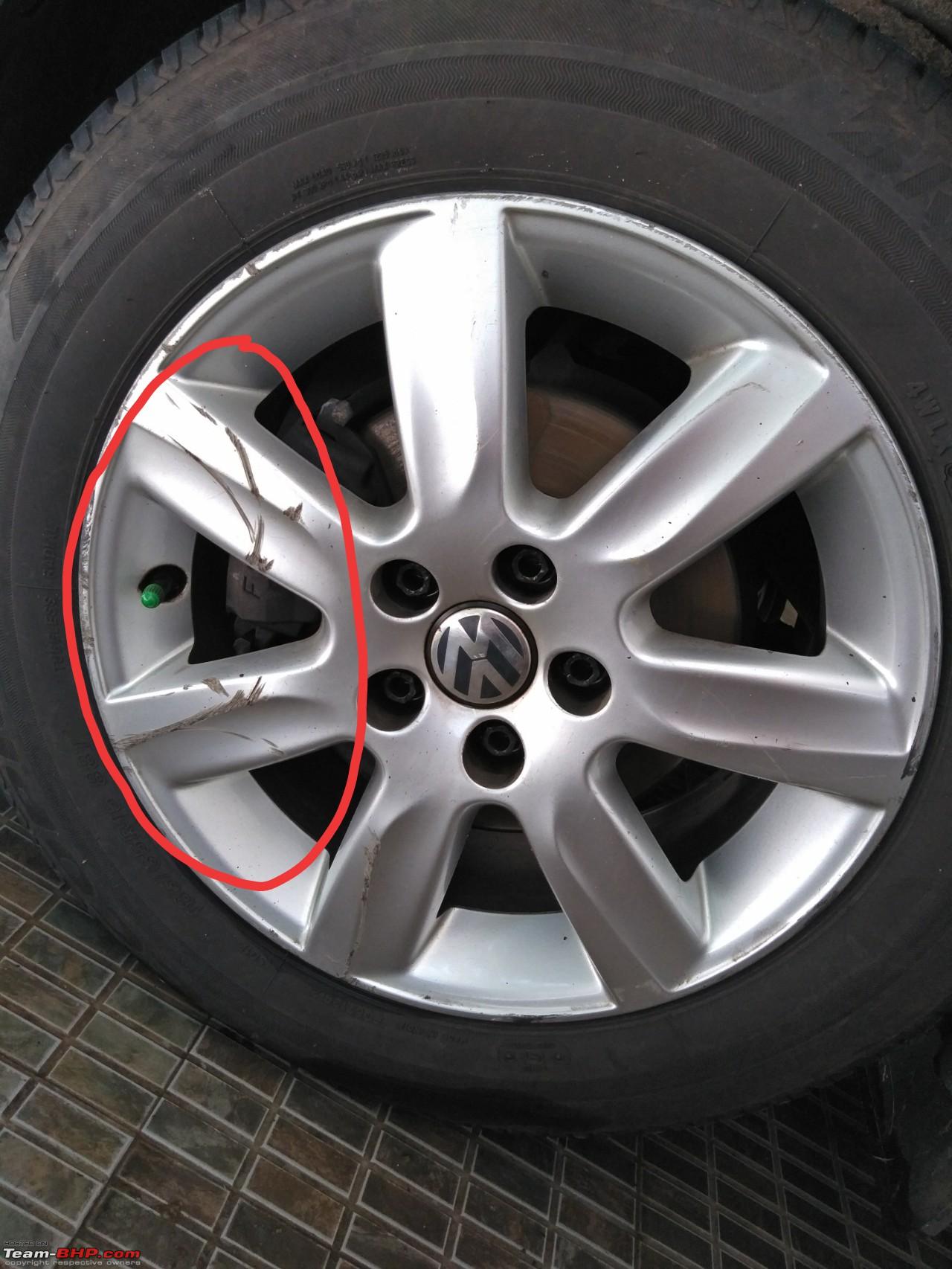

Guys, How to get rid of these scratches in my alloys? Is there any way to easy fix this other than repainting them? Please help with your suggestions.

Old 21st August 2018, 14:27   #10529
Thad E Ginathom's Avatar
Posts: 11,431
Thanked: 29,946 Times
Re: A superb Car cleaning, polishing & detailing guide
I don't know, but it makes me wonder, and perhaps answers will include... Is the finish that we see on alloy wheels a surface coat? Or is it (as I have always assumed) the metal itself, sanded and polished to the required coat?
If the latter, then I suppose that we must file/sand out scratches and try to replicate the finish. And get wheel rebalanced.
Thad E Ginathom is offline   (1) Thanks
Old 21st August 2018, 15:39   #10530
Jaggu's Avatar
Join Date: May 2004
Posts: 20,383
Thanked: 17,291 Times
Those are deep scratches will need some putty, sanding and repaint if you want it perfect. Other option is lightly wet sand and give it brush touch up once dry.
