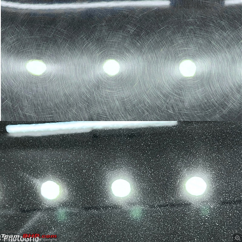

Old 2nd January 2023, 11:39   #11556
AJ56's Avatar
Join Date: Jul 2021
Posts: 861
Thanked: 3,340 Times
Re: A superb Car cleaning, polishing & detailing guide
Originally Posted by sumeethaldankar View Post
The the thing is under the fancy lights which detaling studios have it became difficult to see the marks on the paint. At the studio it appeared that all the stains were gone but at home I managed to see faint residue of the cover paint still there.
It’s a big problem in the detailing industry, most shops use diffused LED roof + wall lights that look great from a distance but do little to highlight actual paint defects, you need bright direct lighting like focus/floodlights to check paint properly. Just see this heavily swirled up GLC, if you ignore the focus lights, a layperson will not be able to see the swirls/scratches in the top picture. The second shot is the same area zoomed under direct focus lighting and here you see everything.
A superb Car cleaning, polishing & detailing guide-b7723355526d443886924b5dd9bf9b33.jpeg
A superb Car cleaning, polishing & detailing guide-ee75a1248284448ab7cf6c0c46a13d34.jpeg
AJ56 is offline   (7) Thanks
