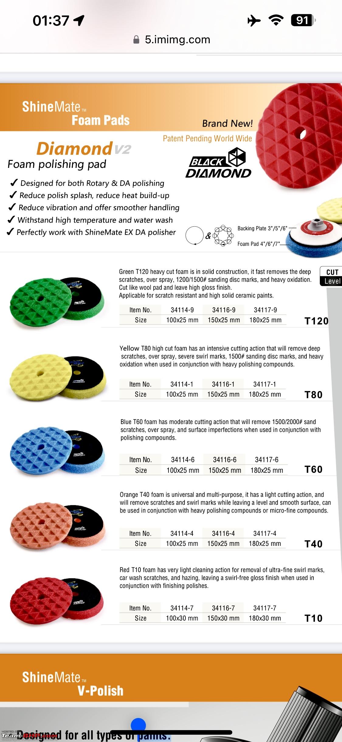

I have a wool cutting pad with me. Now, I am looking for a pad for removing swirl marks, oxidation and minor scratches. I will be using Meguiars Ultimate Polish and Meguiars Ultimate compound.
1. Which ones should I choose from the below?
2. Also, there are flat ones and diamond cut ones. Which one should I choose?

1) With a compound you’d want to go with a medium to heavy cut pad, the numbers are in increasing order of cutting ability. T10 is a plush finishing pad, T40 and 60 are medium polishing pads and T80 and 120 are heavy cut pads.
Personally I rarely use the 120 (green) as it’s too aggressive unless you’re dealing with sanding scratches or trying to remove orange peel.
T80 (yellow) is the ideal cutting pad and goes great with Menzerna 400 or 3D ACA compound.
After this or if defects are minor to start with, go with a fine cut pad like T10 (Red/Black) as most new cars have super soft paint (Volvo notwithstanding). Otherwise you can go with T40 (orange) as well, but T10 finishes much better. Pair these with something like Menzerna 3000/3500 or Capro Essence.
Meguiar’s I’d say use until you run out then move on to better polishes and compounds. Both Ultimate compound and polish are full of fillers to the point it feels like an oil spill on paint. Also it’s a pain trying to assess the actual correction as heavy fillers hide everything. Make sure you liberally wipe with 25% IPA solution to check the real condition before applying your protection.
2) Stick to diamond pattern pads as they dissipate heat much quicker vs flat pads. Heat is your main enemy when doing any kind of machine polishing and the hotter the paint surface, the lower your rate of cut.

1. Thanks for your detailed reply. Getting T10 and T80 for now. I wish I had reached out to you before getting Meguiars. Will definitely try Menzerna once this bottle gets over.
2. Will go for diamond pads. Is https://www.autofresh.in/ good? Any experience buying from them? Or do you have any other suggestions?
