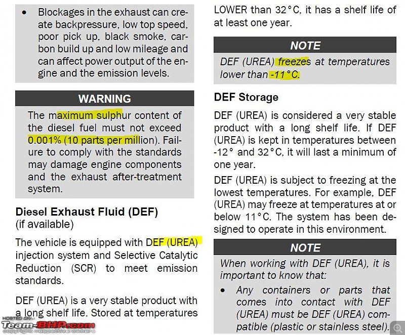

This article mentions about the contents of Harrier BS6 owner's manual. I also checked out the Seltos owner's manual which had similar content. Unfortunately data regarding the clogging and regen of the DPF is so variable that it will depend on the specific application and engine duty cycle. Definitely expecting issues related to clogging in city traffic.
One Seltos owner also posted regarding getting the engine check light on after 1350 kms:
..My Seltos diesel showed engine check light on, after 1350 km, twice after running on BS4 diesel, which was cleaned & restored by kia service. Now my query is, After using BS6 diesel, for short trips & city runs, with out high way trips, will I be able to cover 10k, (being service interval) without facing engine check light warning again due to clogged DPF while using BS6 diesel?

Sharing my 2 cents of observation. Seltos and similar 1.5D based vehicles are opting for the relatively cheaper LNT - Lean NOx trap - method. Larger cars with 2.0L or more displacement diesel engines (Hector, Compass, Harrier etc) are going with SCR - Selective Catalytic Reduction - which is an active mechanism working together with AdBlu or similar urea based additives in the process.
From the statistical number of reported cases of clogged DPFs in BSVI compliant diesel cars (purely based on Google search results, may be wrong also), I feel that the LNT is not capable enough to continue working long cycles when BS4 diesel is used. SCR seems to be doing a relatively better job of it considering lower reported issues.
In most places barring the major metros, I don't think the BSVI diesel has reached (thus resulting in a failure of the much boasted 1 April deadline). And using the existing BSIV fuel is causing issues.
It seems Tata had tested the results of this and had an idea that the 1.5 Revotorq engine with LNT won't run without complaints on LNT regeneration for too long. That is why - the Nexon and Altroz diesels are still available only on paper in most places. Looks like they really tested something during test phases!
