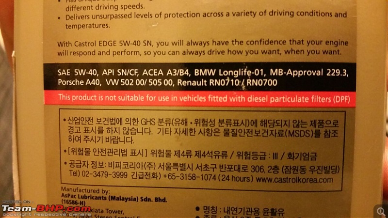

Yes, this conforms to VW 502 00, which is a sufficient oil grade for the TSI engines following fixed serviced intervals. It also has a newer API 'SN' rating compared to the older 'SM' rating of the Castrol Magnatec Professional OE 5W40 supplied from the authorised workshops.

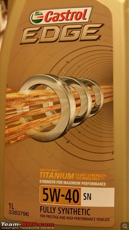

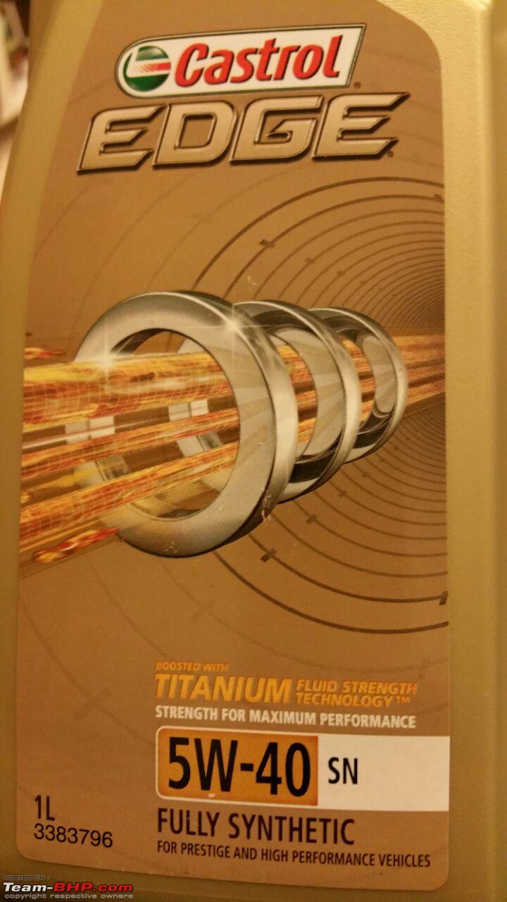

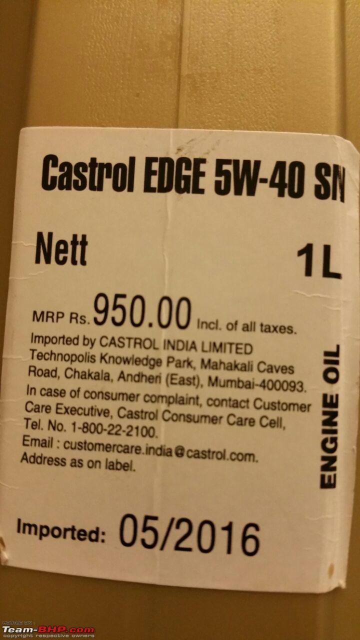

Just got it in impeccable condition and packaging. Manufacturing date also May 2016.

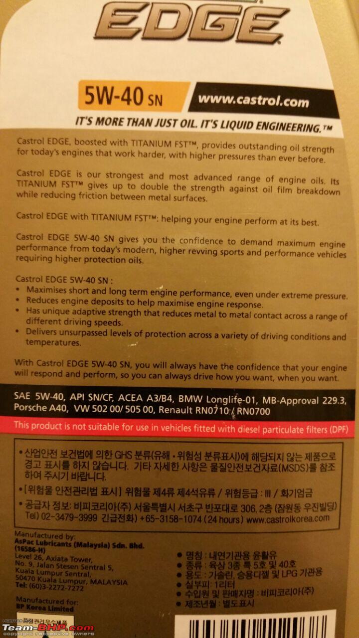

Looks perfect and a very good deal. Noticed Amazon had an offer on Shell Helix Ultra 5W-40 for a low price of 817. Excellent discounts!
For diesel owners, please note the clear DPF warning in red.

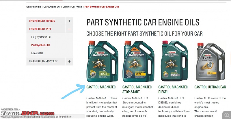

Thank you for the pic. Actually I was looking for the 1 Ltr bottle online and came across Castrol India site where Magnatec is listed as "Part synthetic oil" and Castrol Edge is listed as "Fully synthetic oil" Hence the confusion.
I have attached screenshot for reference.
Any idea where I can purchase (1L can) in Delhi?
It could be for the 10W-40 spec. The 5W-40 listed in Castrol UK's website says fully synthetic.
The Magnatec OE 5W 40 can be bought from the service center. Realising that the engines do consume oil during their daily usage, the service centers are willing to provide a 1L bottle over the counter. Do check with your service center.
