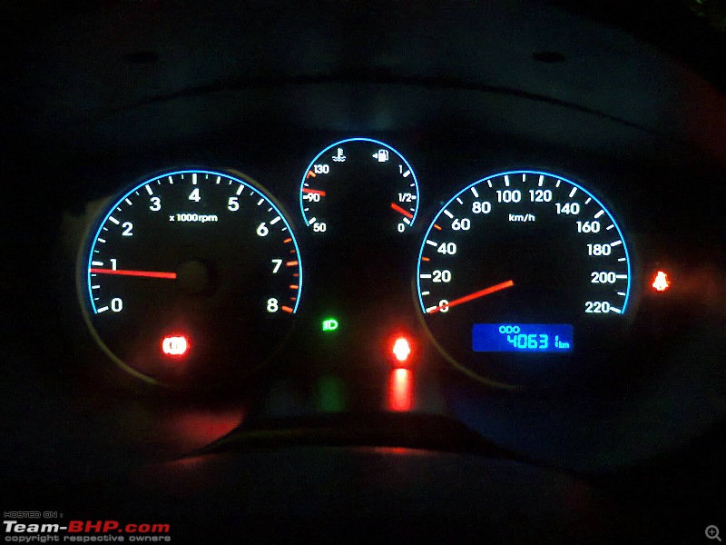

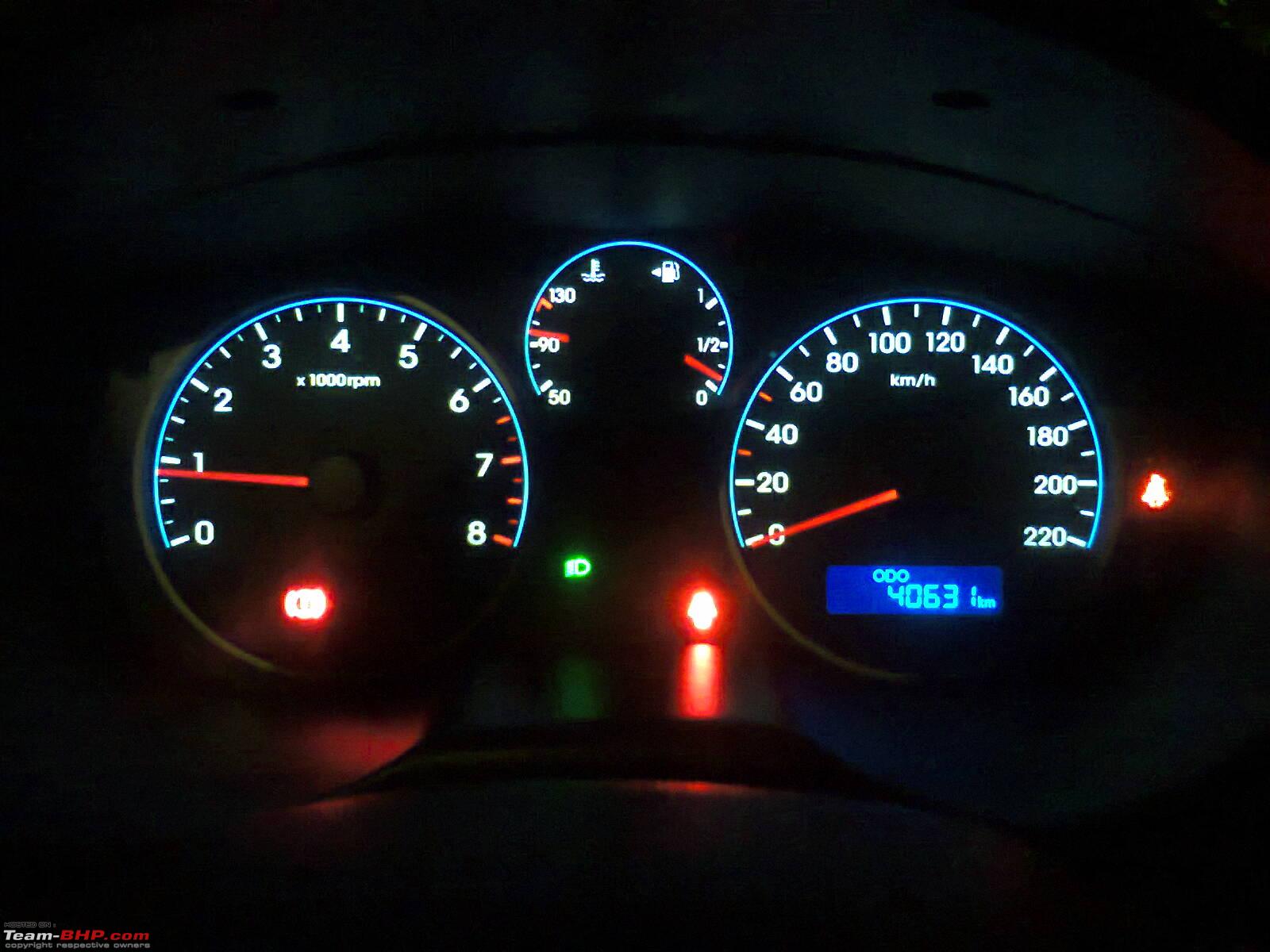

Hi Ray,
It seems my nightmare has just begun. Service advisor called me today at 6pm stating the car is ready for delivery. reached there at 6:30 and i was told that the radiator fins were choked with Slush/debris and they have cleaned the radiator in a chemical. They had removed the condensor etc to carry out the job. They even showed me photograph of the clogged radiator. as per them they had carried out a 30 km testdrive and the water temp never crossed 85 C mark. I was assured that the problem has been rectified.
But i have just returned from south extension market which is a few kms from here and on the return trip, the problem has resurfaced I have taken the pics . Please check the KM readings. On the invoice given today its 40544 while the pic shows 40631.so even with ambient temp at 32C car has overheated. As noticed earlier also i and my friend opened the bonnet, only to find the fan working normally and air temp also seemed to be normal.
Please suggest what should i do now, as the car's warranty is expiring on 7-July and i'm fed up with these repeated visits to workshop, this being the third one.
Also notice the dramatic decrease in Fuel needle level for a distance of only 13 km between two Pics.

Dear Jaspal, as I mentioned to you in my PM, I guess you are at the mercy of the dealership as your car is under warranty. I was wondering about the condition of the coolant but considering this was a fairly new car with only 40,000 km on it I assumed it to be in tiptop condition.
Okay, let's take this step-by-step. First of all let's verify that the engine is actually overheating. You mentioned that the fans were coming on and I think you could feel the heat being dissipated from the radiator, am I correct? We need to know if the temperature of the coolant in the system is actually what the gauge is showing us.
I am assuming that your car was running at around 90°C prior to the overheating problem. Now let's see if it is actually overheating under the hood. The best way to do this is with a temperature gun, do you have access to one? This will enable us to read the temperature on the radiator, on the thermostat housing, on the intake and outlet hoses etc. This should correspond with the temperatures depicted on the gauge. If this is not the case then it seems we have a problem with your instrument cluster gauges - which could explain the inaccurate readings on the fuel gauge is well.

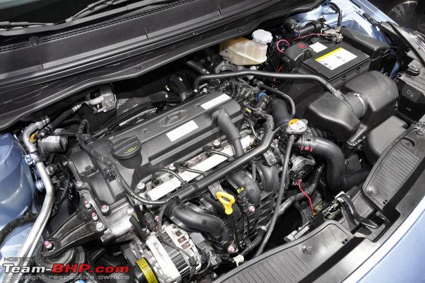

Jaspal, just curious, you mentioned the radiator being cleaned by the dealership but nothing about the thermostat. Also you indicated that when you and your friend opened the hood the fans were working and the temperatures seemed okay - could you feel the heat from the fan/fans as they were trying to cool the radiator? Coolant seems to have overflowed from the front of the car - that's good/normal with the system overheating.
Also, did you put the heater on with the blower on full, (vents pointing towards the windows), to bring down the temperature? If you had done this and the temperature had come down, this would have indicated the following:
1. That the water pump was working fine - coolant was circulating well
2. That you had enough coolant in the system - no air pockets
3. System had the ability to bring down the temperature - no cracked head etc.
In any case, as I mentioned to you earlier, it seems as though you are at the mercy of the dealership/manufacturer and hopefully you will be grandfathered in even if the problems persist after your warranty expires.
I'm assuming this is what the engine layout looks like in your car.
yes this is the same engine Rest we have already discussed over phone.
