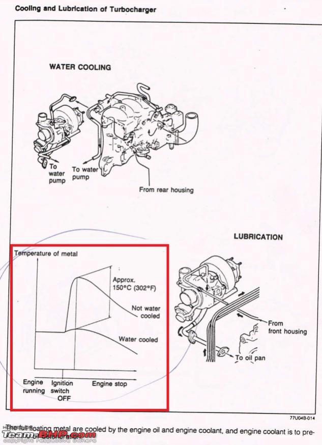

Strangely enough I have not seen people talking about oil cooled vs water cooled turbos in this thread. Water cooled turbos do not suffer from coking. Only oil cooled turbos do. Are all our OEM turbos oil cooled? If they are then they need to be spooled down but not if they are water cooled. Mazda had done some research on oil cooled vs water cooled turbos. The results are pretty clear in the attached photo.
Why you must practice the "Idling Rule" with Turbo-Charged Cars-oil_vs_water_cooled.jpg
So the point of my post is that it would help greatly if we knew what vehicles are being sold with what kind of turbos.
Source: http://www.rx7club.com/single-turbo-...turbos-966424/
Attachment 1044690
AFAIK Linea T-Jet comes with a Water cooled Turbo,where as the one on MJD is the usual one.
Quite a few mentions of it on the last page of discussion itself. This does make a big difference, but you also cant deny that it would still be advantageous to cool-down before shutting down (though not to the same degree as an oil-cooled turbo).
I'd like to add another one to the mix : what about ball-bearing turbos?
cya
R
Ball bearings seldom suffer from coking as the rolling action of the balls erodes away the coking. But an important point to be noted, most commercially available ball bearing turbochargers are water cooled. Need to do more research on why this is.
