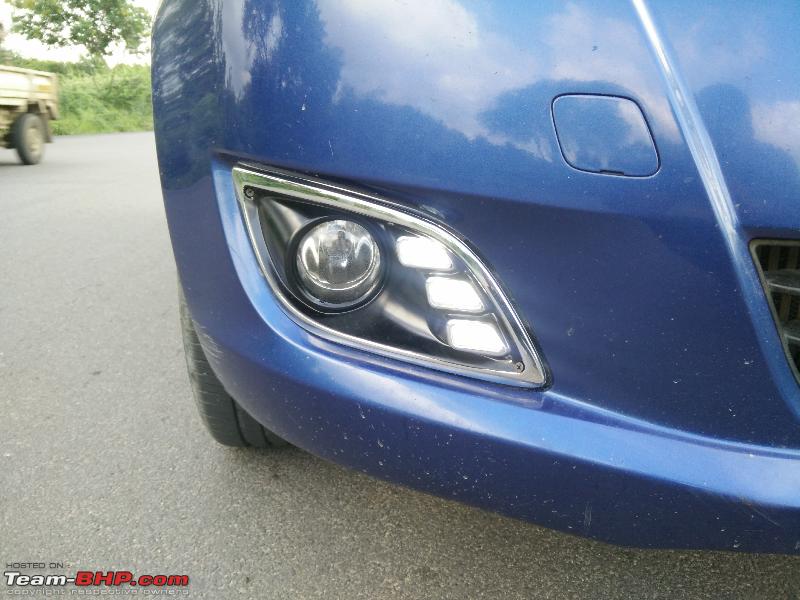

I have installed DRL in my Swift from Ebay. Here are a few images of it.
Here's the link to the thread:
http://www.team-bhp.com/forum/diy-do...tallation.html

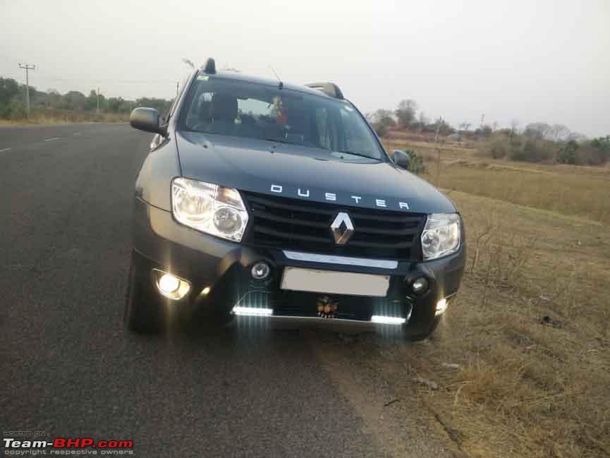

Day light running lamps were the first item in my bucked list when i brought my Duster. I have bought these from Aliexpress which consists of 6 LED DRL's along with the wiring harness and the controller.
Based on the suggestion of few friends and experts, I have directly connected the DRL controller to the battery, where the power supply is controlled by the 40A, 5pin relay which is triggered through the ACC power taken from the cigarette lighter source. This avoids using the existing car wiring and hence there is no load on it.
The LED's operate only when the engine is started and are ON for few seconds even after the car engine is switched off, thus giving me a follow me home effect.
The only thing i could not understand is how come the DRL's switch ON only when the engine is started, even though the power is routed when i throw the key into ACC position?
But alas like any cheap Chinese products, i am able to see that few led's have stopped glowing over a period of time ( around 1 year) .
Attachment 1614935
Stumbled across this thread just now when I was looking for a DRL setup for my own car!
The reason why the controller lights up the DRL only after engine starts is actually painfully simple. The battery voltage & current changes once the engine starts & alternator is working. That difference can be easily sensed by the controller to switch the relay :)
