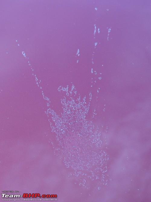

Etching from bird droppings

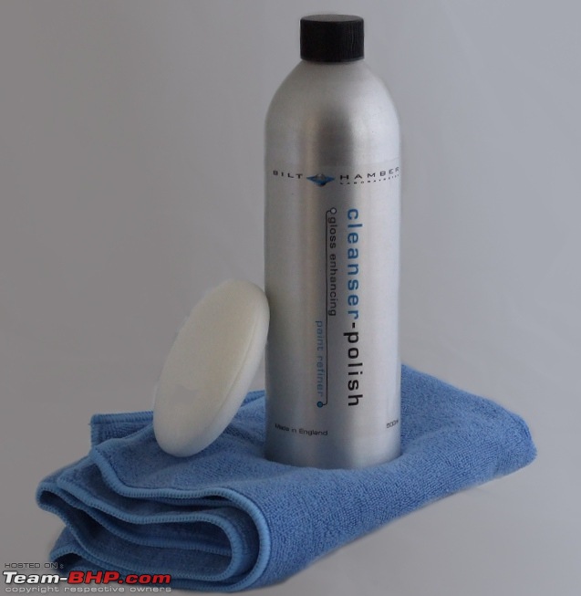

BH Cleanser Polish
Pros:
  • Above average paint cleaning ability by hand
  • Easy to work with, spreads & removes easily
  • Doesn't just hide defects but actually corrects to an extent
  • Has some added fillers and they come in handy when working by hand
  • Excellent gloss
  • Has a small amount of sealant in it so can be easily topped up with any sealant or wax. (However, an IPA wipe down is still a good step to ensure sealant bonding when using a sealant from another brand)
Cons:
  • Not available in India at the moment
  • Designed for use by hand, there is no information if it can be used via a machine

a. A deep scratch like something has rubbed against the paint. It is so deep that I can insert my fingernail in it.
b. A very narrow but deep hole which looks just like the stone chipping pic that you have showed in your post.
Can you please let me know if I can correct it myself (I don't have a DA polisher) or should I take the car to a professional or body shop? If I can DIY it, please suggest a good compound preferrable which is available in India. Also I don't like to spend a fortune on it
a. If you can insert your fingernail in a scratch, it needs to be filled up (Body shop / wet sanding / Painting)
b. Stone chip sites will rust if not protected. either use an anti corrosive like Bilt Hamber Auto Balm or add some clear coat to it using one of those Dupont Scratch repair pens. Body shop can fix it for you, if you are going there for the scratch anyway.

Many options - Carpro PERL, Optimum Opti-Bond Tire Gel, Meguiar's Natural Vinyl Dressing, Ultima Interior Guard Plus, Sonax Interior Protector are all good stuff.
