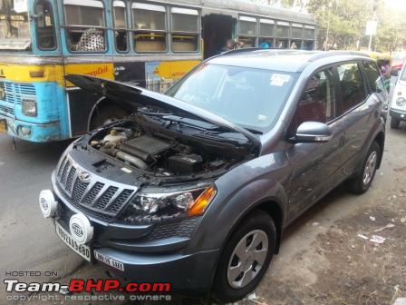

Last Saturday, I was taking my wife and kid to my in-laws place, and around 500 meters from my place, while downshifting from 4th to 3rd, the engine dies. In the beginning I thought I have stalled, but then even on cranking the engine wont start. I was stranded in the middle of Ruby Connector , one of the busiest roads of South Calcutta. Shoving a 3 toner from one side to another, and fitting into curb side parking without power assist is a herculean task, believe me. Opened the bonnet and tried to analyse. Starter motor cranking, so the fuse is alright. Checked if oil had water in it. Primed the hand pump to expel air, if any.Nothing! The engine wouldn't fire. There's no check engine light, no indication whatsoever. MY XUV WAS DEAD!!
Called up my relationship manager, he promptly diverted one of the service advisers who has gone to attend a breakdown to me. He checked and couldn't find any fault, said " Sir Leke chalo ". I called up the "with u hamesha" 1800, number, whom I had to explain at least four times on my location ( she was asking whether I am on a highway, when I have told her that I am in South Calcutta, heart of the city). Okay discount that! Then the service support guy called, he tried to help remotely which was nice, cause I am sure there are Johnnie's, who don't even open their manuals. After going thru his SOP, he said he would be dispatching a flat bed truck, along with a cab for me ( I declined). Jolly Good! I have to wait for 1 hour as per him. This one hour went on to become 2, and the flat bed arrived. Okay Discount that! This is India, how much would be the worth of one hour. Nothing! Not to sound caustic, there's also the issue of Traffic.
(Note : This flatbed services are outsourced, not M&M/any dealers, hence they have other commitments with other manufacturers including Merc's, Beemer's, Jag's, Maruti's, Fiat's etc etc), so the service request is like FIFO! If you ever have to wait for a flatbed, try to relax cause it takes time). Even the experience was okay, I would suggest there's a scope of improvement, the time gap between the steps can surely be worked upon.
The guys were efficient, they promptly took the car up the ramp on the flatbed, the winch was prehistoric and the steel cable was not actually very inspiring, but it did its job. Does anybody want to know, how that Ape in the cage thinks when you look at him and explain to your kids about the usual ancestor thingy. Yes? Good Sit on the steering wheel of a car which is on a flatbed and then come and tell me. I had to withstand this ordeal for 30 minutes. And we reached the A.S.S around 4.30 ish. The car was promptly unloaded and taken to the bay. Initial diagnosis was that engine was having no compression. There wasn't any fault codes detected by their software.

My Mahindra XUV5OO goes DEAD. Update: Engine Replaced-20140208_141641r.jpg
My Mahindra XUV5OO goes DEAD. Update: Engine Replaced-20140208_155600r.jpg
My Mahindra XUV5OO goes DEAD. Update: Engine Replaced-20140208_170051r.jpg
My Mahindra XUV5OO goes DEAD. Update: Engine Replaced-20140208_170105r.jpg
