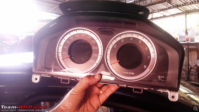

re: Volvo S60 instrument console failed. Repair or replace? Volvo to replace under Goodwill!
I had already posted in a few international forums along with tBHP.
Some of the people who repairs the DIM has told me that the speaker is supposed to be inside the instrument cluster itself.
Apparently there are holes for the sound to be heard outside.
we were looking inside the dashboard, not inside the DIM.
There is always something new to learn. Next time the plan is to go for the DIM itself and try a surgery and see what the internals are like.
Originally Posted by lurker View Post
If you want to get this repaired in India, I guess it will have to be a risk because surely there can be no Volvo specific techs here because of low numbers.
OTH if you indeed want to take a risk, then any company that deals in medical equipment or digital speedometer repairs and equipped with an electronics bench could surely take a look, and if it is indeed some marginal issue like loose contact or moisture ingress then they could repair it for you as well.
Or else better ship the DIM to some company who specializes in this (most likely in UK) and wait for them to do a good job.
Thanks Lurker
That's exactly my plan.
If it is the speaker or the wire, will get it done by the friendly neighbourhood electronic wizard.
Otherwise it has to be clusterrepairs, volvodiagnostic etc. in uk or xemodex in canada or something.
When we had the cluster in hand we were looking at it the wrong way.
We should have been looking at the back side of the DIM, instead of admiring the beauty of the front side.
Volvo S60 instrument console failed. Repair or replace? Volvo to replace under Goodwill!-image323dc95798e45fcd8f50c7805e96d0cf4756b24391a4b03579c886363a152c5fv.jpg
