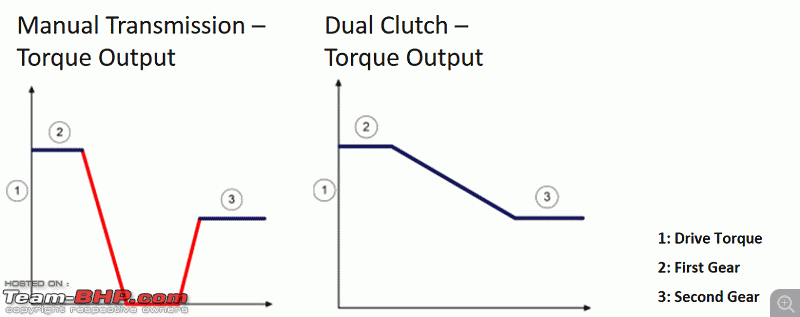

I have a couple of questions though.
In the figure below, how is the torque being transmitted in the sloping section of the blue line?
