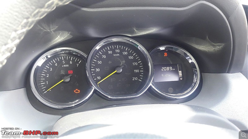

The following light comes up when the injector fails.
This leads to decreased acceleration with power loss. Vehicle starts vibrating on flooring down. Since vehicle doesn't respond to the throttle given, the ESP kicks in and shows its error too.
