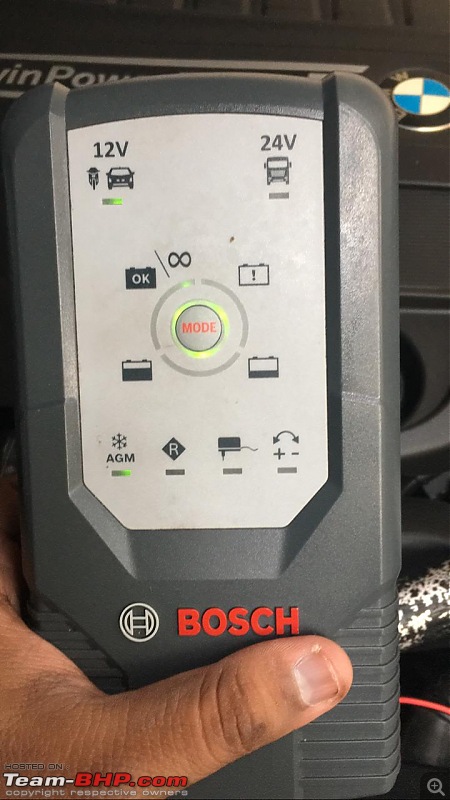

I've had two test-drive cars in the recent past (drove them around Bombay), and an outstation trip for which I flew down to another city. As a result, I haven't started the 530d in 10 - 12 days.
No stress on the electronics though. My staff sent me a pic of the charger from this morning. Fully topped up:
