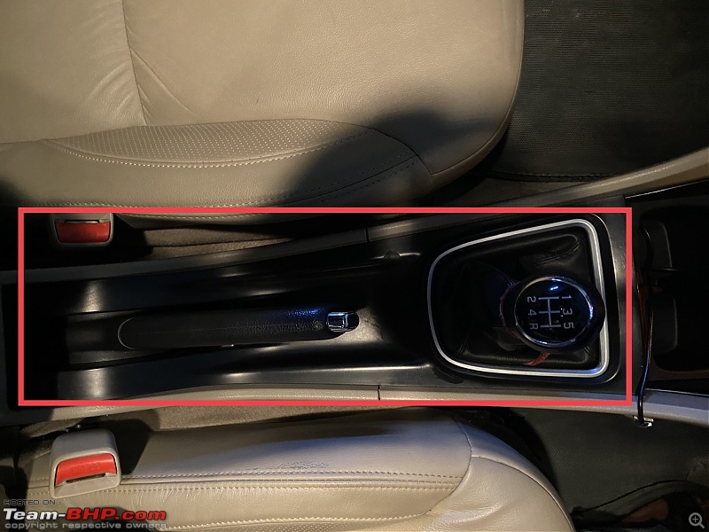

I am looking for part number for this plastic part for Ciaz 2018 model 1.5 Alpha, this part is wearing off in 2.5 years.
Thanks

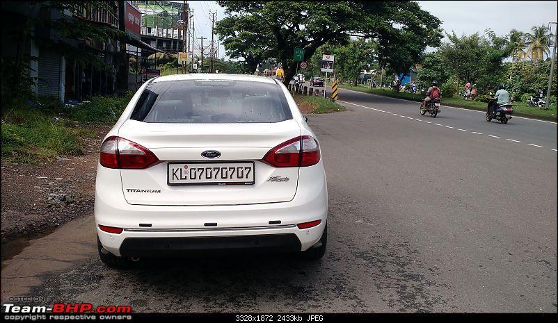

Hello Shashi, need one help! Can you find me these rubber guards? The 3 small black ones that I have on the bumper of the Fiesta. They are well made, subtle and do the job.
Maruti Genuine Parts (MGP) Catalog: Post your queries here (model list on Pg 1)-img_20170721_090104567.jpg
Is it not available with MGA anymore? If you can find them, please go ahead and buy if its not too much trouble. Needless to say, I will cover all cost including shipping - I can DM you the details.
