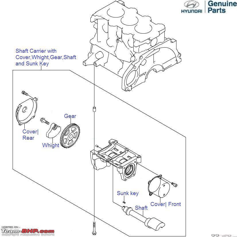

Hyundai 1.1 U2 CRDI : Grand I10 & Xcent
http://www.99rpm.com/hyundai/balance...grand-i10.html
Fiat 1.6 JTDM 2 / Multijet 2 : S-Cross 1.6
http://www.drivewhat.com/latest/revi...d-performance/
1.6 multijet is import from Italy and I am not very sure about 1.1 Hyundai CRDI.

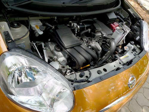

I believe the Tiago diesel comes with a balance shaft (but not the petrol). The nice Beat Diesel also has one.
The Micra 1.2L petrol has a surprisingly refined idle for a 3-cylinder. It's got an outer balancer, Nissan says:
GTO is offline   (2) Thanks
