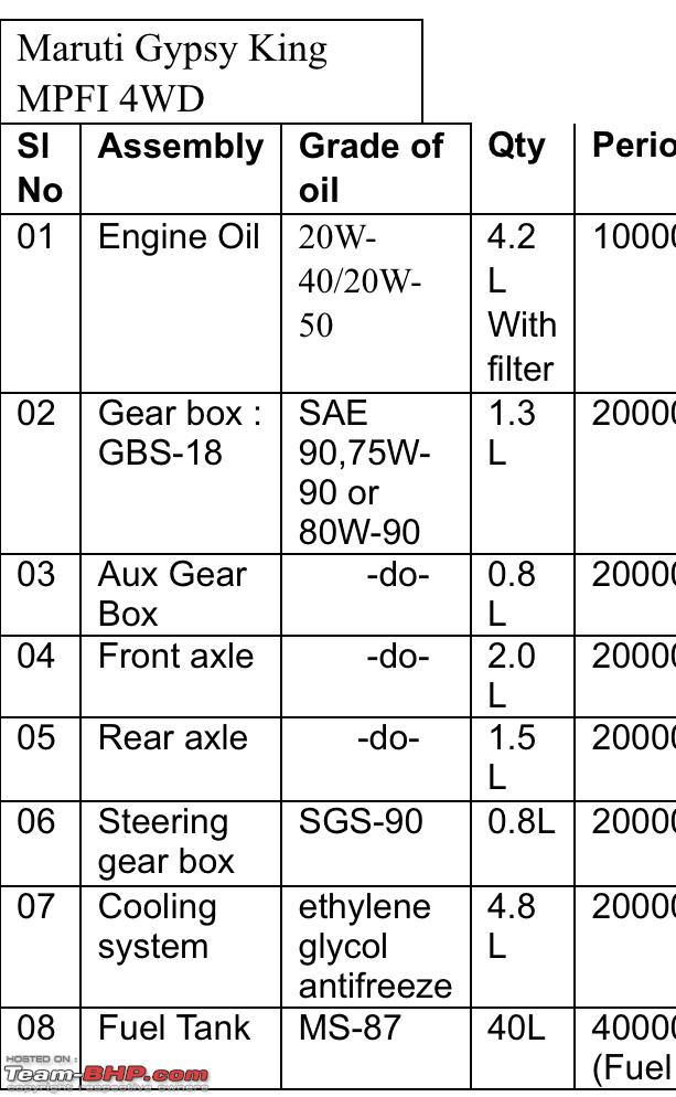

Why can't Maruti Suzuki mention all the fluids (Engine oil, Transmission oil, Brake oil & Coolant) that needs to be replaced in the owners manual or with a sticker inside the engine bay. Like the one below (Credit: ChrisFix)
It should have all the details such as the SAE Viscosity of the oil to be used along with the API Certification, quantity to be used (including oil filter) and the change interval (both in kms & year). This will clear the confusion for both the owner as well as the mechanic.
Service manual mention all these details but the quantity to be used for the engine oil is more as draining the engine oil from the drain bolt will clear only 80% to 90% of the engine oil and the remaining will still be there inside the oil galleries.

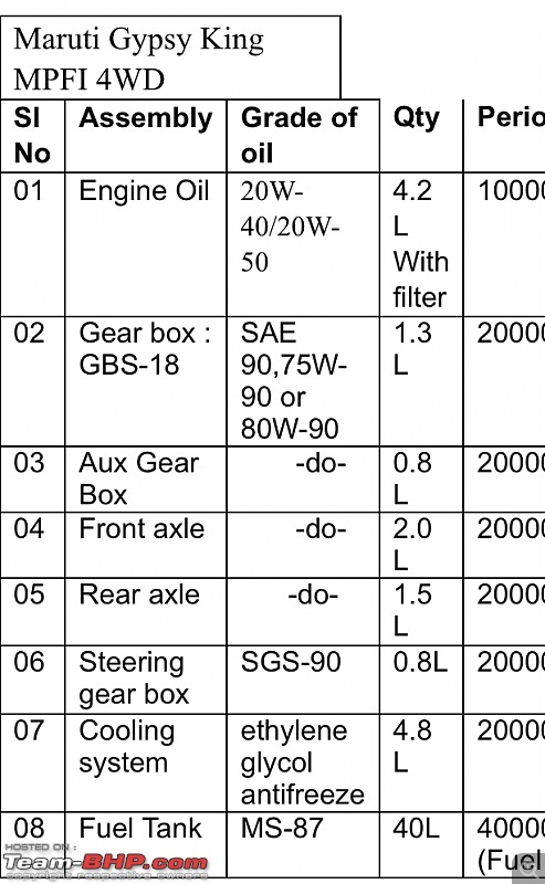

Here is the relevant information for Gypsy King 1.3 Mpfi
