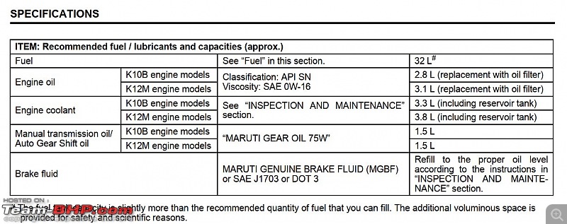

After Ciaz and Ertiga 1.5 Petrol, Maruti Suzuki has moved to 0W16 grade for even the New WagonR, both K10B and K12M engines
Looks like all K series engines will eventually move to 0W16 grade.
Leoshashi is offline   (7) Thanks
