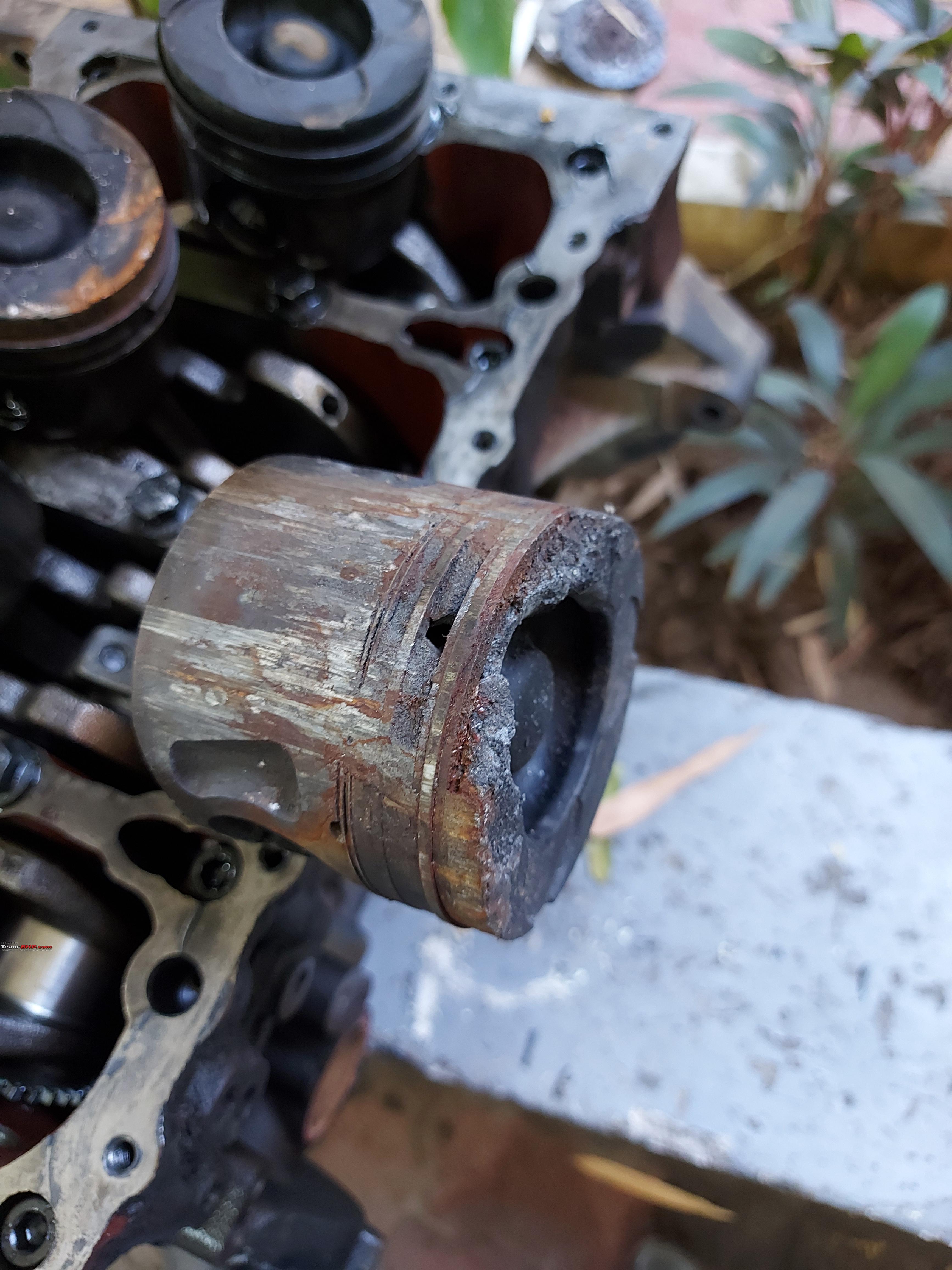

At the MASS - Pothen's Mahindra, he has shared a diagnosis of faulty valves expected damages to his pistons, rings, bore etc.
However, on opening the head they do not seem to see any issue there and are recommending, head and valves replacement + engine overhaul all free of cost since its covered under warranty.
For me - I am still trying to figure out why open the engine block and MASS does not seem to have found any issue with the engine in itself.
As an owner of the car Bijesh is quite puzzled and is struggling to get through all this given that his car is still within warranty. He feels his car deserves a new heart given that the engine head has been opened within warranty and he is not sure of an overhauled engine in a less than 5 year old car.
I too feel the same, and I suspect something not right from the MASS / Mahindra Customer Care given the way they handle the issue.
If there is anyone who can help me guide Bijesh based on his notes below, will be of great help.

02-Dec-2020: I was driving back from office at around 7.30 PM as usual when I felt a sudden dip in engine power. I checked for engine warning lights and Low fuel indications, but none was ON. There was more than half tank fuel as per the fuel level meter. Since it was a busy intersection that I was driving through, I stopped the vehicle 100 meters away from where I felt the power loss to a side road. I then called my regular SA at Pothens Mahindra, Ambattukaavu who advised me to check for warning lights and gave the contact details for RSA. I rang RSA and they gave the link to locate my vehicle and identify the nearest MASS (Pothens Mahindra, Cheranalloor).
Within 40 minutes the RSA team came and since the car was inaccessible for the towing truck, they drove the car to a wider section of the side road where I had parked. Even though the car was barely starting, the engine repeatedly going on and off, the RSA guys drove the car for around 50 meters to the wider section. Then I noticed white thick smoke coming out from the exhaust as well. Only later when I saw the towing truck, I realized that RSA guys were not MASS employees, but some 3rd party towing service team. They then took the car to Pothens Cheranalloor.
03-Dec-2020: Next day morning Service Advisor from Pothens Cheranalloor called and informed me of the receipt of the vehicle and that they would update me about the issue after inspection. Afternoon, I called back to check for updates and got the response that they would start inspection only by evening. Later that day, I called my regular SM from Pothens Ambattukavu to inform him about my vehicle.

05-Dec-2020: Received a call from the SA at around 11.00AM and informed that they tried replacing the injectors and turbo charger, to no avail. He also informed that the compression pressure at all cylinders were around 230PS and that it was very low and that they need to dismantle the head to do more investigation. I asked the SA not to dismantle the head and instead escalate it to M&M from their end as the vehicle was on extended warranty. Around 11.30 AM the SM from Pothens Cheranalloor contacted me and insisted on dismantling the head which I refused straight away. I then visited Pothens Cheranalloor to take documents and personal belongings from the car and insisted the SM again to escalate the issue to M&M keeping me in Cc.

Here are pics of a 2016 XUV500 engine that apparently suffered loss of coolant. No other details are available but the odo read 1,39,800km. One piston(cylinder #2) is totally gone and two others have scoring marks on them. The cylinder head looked quite good to me.
Engine block just after cylinder head removal
My Mahindra XUV500: Engine overhaul required-xuv500_engineblock_asis.jpg
Cylinder Head bottom - note the imperfection over cylinders 2 and 3
My Mahindra XUV500: Engine overhaul required-xuv500_cylinderhead.jpg
Piston#2
My Mahindra XUV500: Engine overhaul required-xuv500_piston2.jpg
The other 3 pistons - note the scoring marks
My Mahindra XUV500: Engine overhaul required-xuv500_pistons.jpg
