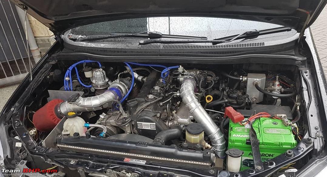

Sankar's Crysta should be the only modified Crysta in India. Remaps are not available yet. He has installed Unichip ECU. This has got lot more control over the engine than remap and should be fun to play with :D.
His car has done 567 NM at wheels on dyno :Shockked:
Gosh! No wonder the brakes (and tyres?) need an upgrade. A real sleeper alright. I'd love to see some sedans take this car on. Should be fun to see a ricer in the RVM and watch it zoom past.
