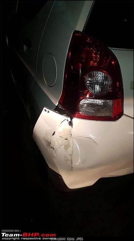

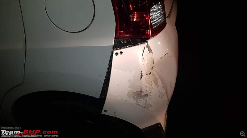

Days went by without any issues. Then the inevitable happened. Was on our way to the service station with my cousin. It was a busy evening with speeds below 10kmph or less in b2b traffic. Was crawling along and on seeing the traffic standstill, applied the brakes as usual so as to bring the car to an halt. To our surprise or should I say horror, the brake pedal was hard as a rock (was like there was a brick under the pedal). And there was this loud grinding noise (ABS kicking in). There was absolutely no warning on the instrument cluster when this happened. Knew there would be an impact so swerved to the left so as to minimize the damage to the car in front. Unfortunately, the collision couldn't be avoided and hit the left side of the car. The A Star took all the damage here and just a minor scratch on the Creta.
Hyundai Creta: Serious brake failure issue (must-read for all owners)-img20191031wa0012.jpg
Hyundai Creta: Serious brake failure issue (must-read for all owners)-img20191031wa0013.jpg
The ones marked in the box are from this accident. The bottom one was already there. Most of it can be buffed out. Just a minor spot where paint is missing.

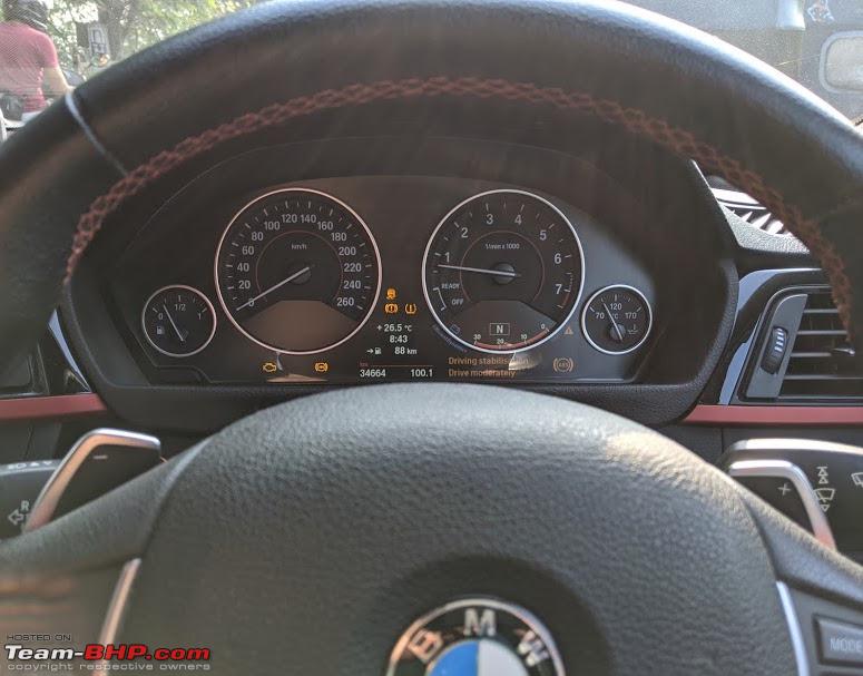

The ABS, Traction Control, Tyre Pressure Monitoring System etc. is controlled by a single sensor called the (Wheel Speed Sensor), each wheel has one & the wheel speed sensor failing is a common problem in F Chassis BMW's (specially the 3 series).
In case of a failure of this sensor all lights light up in this way;
Hyundai Creta: Serious brake failure issue (must-read for all owners)-img_20191115_084636.jpg
BUT, never have the brakes been jammed in the BMW. Infact you can drive normally too at highway speeds.
I really dont think a failed ABS sensor can jam the brakes, it may just disable the ABS, traction system. Hence, there should be more to it than just a sensor failure, hope Hyundai India personally get involved in this case & make sure other Creta owners dont suffer.
