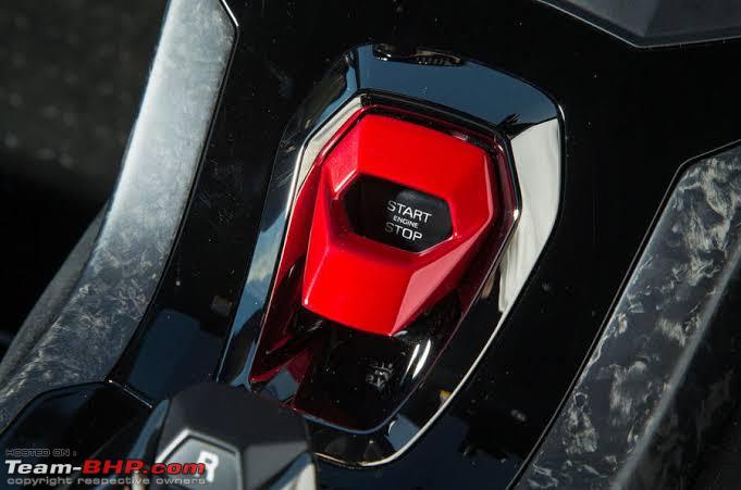

I just hate the whole idea of an e-brake. The satisfaction you get each time after pulling the handbrake is unmatched. Personally, I see this whole action of pulling a sturdy handle as a full stop to a good drive. It gives a sense of accomplishment and completion.
Anyways, if the manufacturer wants to provide an e-brake switch in the centre console, it should have a flip cover over it, just like the Lamborghini's start/stop button.
The dangerously stupid e-parking brake location of modern cars-images-10.jpeg
