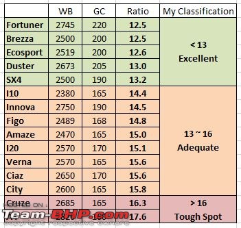

Voted for Option 2, though I'd have preferred it to be worded as "I need a GC on the higher side. Better safe than sorry".
I use a Fiat Palio Stile 2007 and drive mostly in Kerala and Tamil Nadu, with occasional trips on bad/rough surfaces. With 5 people on board, I have to be extra cautious not to scrape speed breakers or rocks.
Based on my experience with various cars, I have judge based on the empirical Wheelbase:Ground Clearance ratio.
Ground Clearance: How much do you really need?-11.jpg
I like hitting new roads and going to places with unknown traffic patterns and need the assurance that my car can go off-road. On the low slung cars I hate shedding speed and the fact that the planning needs to be more thorough in terms of the roads it is being driven on.
Peace of mind is paramount.
