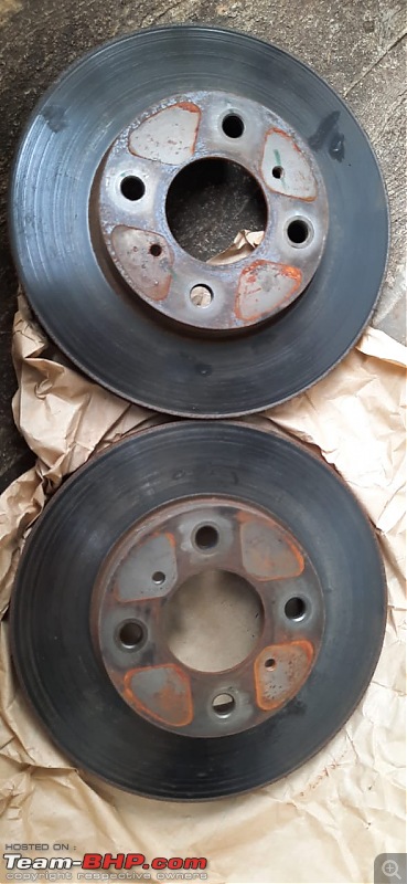

I've had exact same experience as OP with my 2019 Honda Amaze 1.2 iVTEC. The car has barely run 25,000km and the Service Engineer at the Authorized Service Center near my locality told me I needed to replace both front brake pads as well as brake disks and charged me around Rs. 9000 for replacing a pair of pads and a pair of disks. When I asked him why the disks were getting worn out so fast, he said it depends on the driving style and the disks had grooves on them so they had to be replaced. He also added that they could have been shimmed if the car was a City and added that the Amaze comes with pretty thin discs from the factory.
To be fair, I did complain about brakes not feeling up to the mark when I handed over the car for its scheduled 30000km / 3rd-year service. But the explanations given by the Service Engineer do not seem satisfactory to me.
How would a driving style change cause grooves on the brake disk? After all, the driver is only ever interacting with the brake pedal. Ideally, the disk should have worn evenly, if everything was working as designed, right?
I am not an expert on this subject matter, I shall attach a few images of the replaced pads and disks. I would like some advice from the community on this.
When do brake discs require replacement?-whatsapp-image-20221211-11.33.52-am.jpeg
When do brake discs require replacement?-whatsapp-image-20221211-11.34.30-am.jpeg
When do brake discs require replacement?-whatsapp-image-20221211-11.37.36-am.jpeg
Basis the pictures the Brake Pads needed to be changed. They seem to be wearing rather thin.
The rotors appear to have become grooved. This is because they seem to have borne the brunt of hard braking and/ or plenty of stop start city driving. Also in our operating conditions oftentimes little stones and debris gets trapped in there and creates these grooves. If the rotors indeed are also worn down it is worth changing. Skimming the rotors is an option yes, but it is only a temporary one. And yes, the condition and wear of your brakes definitely has a bearing on your driving style too.

Need your expert advise regarding front Discs of my 2016 Verna Fluidic 4S petrol 1.6 VTVT automatic which has only done 5200 kms in these 8 years.
As you can see due to frequent non usage front discs have developed a lot of rust and groove marks on the non rusted area.
I am planning to go for service soon so should i get them replaced or it possible to skim / Lathe them with out structurally compromising them ?
There is absolutely no problems with the brakes - no grinding no squealing and they work perfectly.

Get them skimmed at a lathe. The outer area of the disc is not in contact with the pad when braking. Hence that discolored groove. Braking would have reduced due to that.
Most likely, the pads will have uneven wear.

Both Sides. Discs and Pads are stock that came with the car.

To me, from the pics, it looks like the area where contact is there has no grooves and the area where contact isn't there (the outer 1/3rd of the disc) also doesn't have grooves either - eliminating some physical object (like a small piece of rock) to be the reason for this. Highly likely that incorrect size pads are fitted to the caliper. Does this have rear disc brakes as well ? If yes, high chance that someone at factory/A.S.S fitted the rear pads instead of the front ones, into the front caliper. Is this present on one front wheel or both front wheels ?

Present on both the front wheels. Rear brakes are drum brakes.
