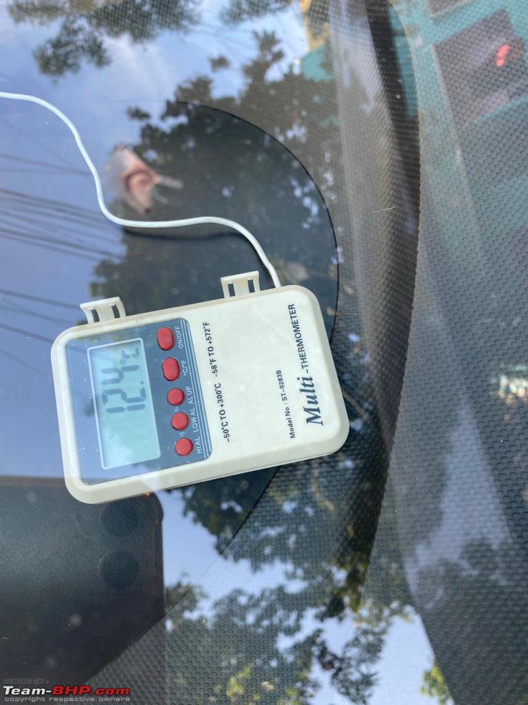

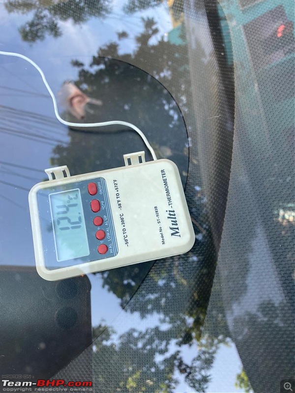

AC vent temperature of 12.4 Celsius is quite high AFAIK. Last week when I went to get my 15 year car for its regular ac gas top up, the vent temperature dipped to 3.5 Celsius in 5 minutes.
The trick AC service center does to reduce vent temperature is to pour out water on the condenser to cool it faster. You could also try it, Let you AC run in stationary car till you feel unsatisfied with the coldness of air, let the condenser get warm, now pour water on to the condenser. If AC starts blowing colder air again that means the condenser is not able to dissipate heat. Could be a weak radiator fan /ac fan, or clogged fins.
