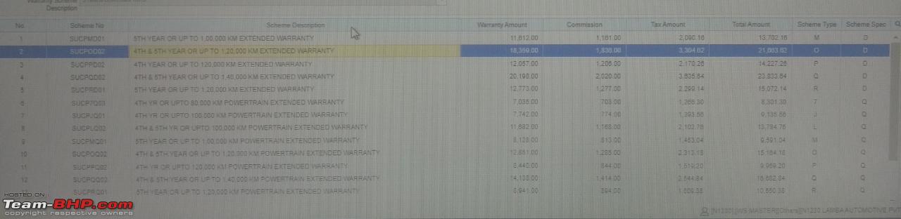

- Have also opted to go for the extended warranty @ Rs. 23,834 for 4th & 5th Year or 1,40,000 KM.
- Attaching the current price list sent by HASS ST (excuse the poor quality photos)
Hyundai Creta 1.4 DCT develops powertrain failure. EDIT: Problems continue even after 2 years-whatsapp-image-20210615-1.50.42-pm-2.jpeg
Hyundai Creta 1.4 DCT develops powertrain failure. EDIT: Problems continue even after 2 years-whatsapp-image-20210615-1.50.42-pm-1.jpeg
Hyundai Creta 1.4 DCT develops powertrain failure. EDIT: Problems continue even after 2 years-whatsapp-image-20210615-1.50.42-pm.jpeg
- Fellow Creta owners, do note that the extended warranty prices go up by 10% or so after 90 days of purchase. I highly recommend getting it as soon as you can.
- Also don't get confused by the 5th year/4th year/4th & 5th year options mentioned. Hyundai takes the base duration as 3 years for all Wonder warranty durations an then offers prices for 4th year (standalone), 5th year (standalone and applicable if you had taken the 4th year standalone) and 4th & 5th year (applicable to most of us as it doesn't seem to make sense to take 4th and 5th year standalone).

- Prices across HASS are fixed for the extended warranty, however, some freebies can be negotiated. I got a free underbody coating coupon from Lamba Hyundai with a two month validity and they even sent someone with a card machine to swipe the extended warranty charge.
