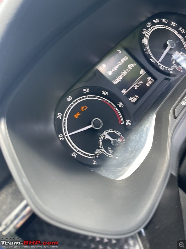

Console pic -

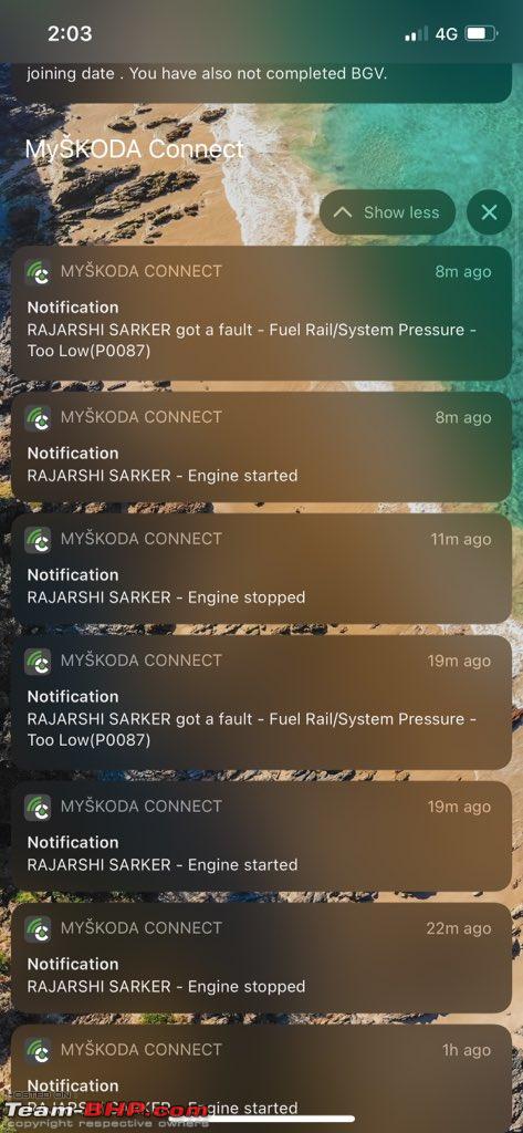

Log from Skoda Connect app -

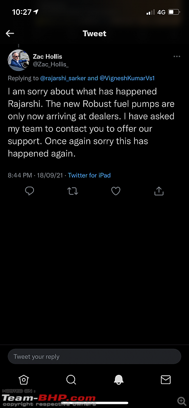

Rajarshi says something similar in one of his tweets.
Just came to post that. Zac did reply with this same comment - so hopefully that gives Skoda the benefit of the doubt.
Though this contradicts his earlier email on 15th September 2021 (posted in the previous page) which stated that the pumps have already reached dealerships and fitted to a customers car.

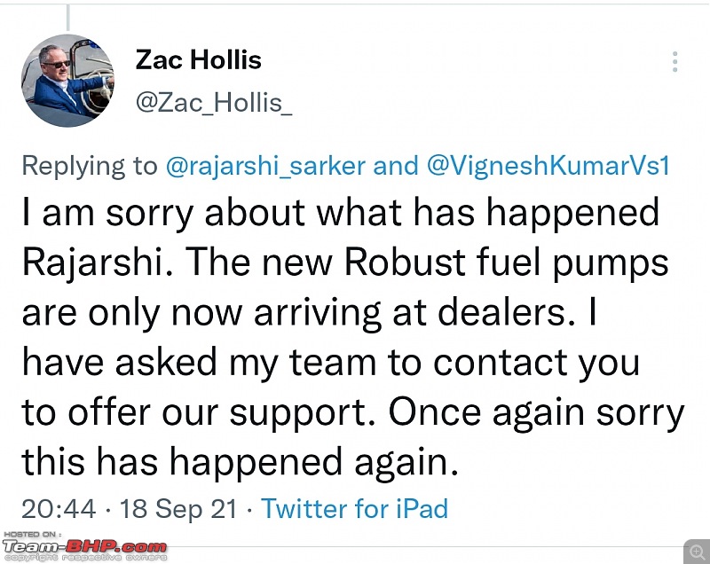

Thanks Moderator for sharing my post on this platform. I actually got a reply back from Zac on twittet. He has stated that they have started dispatching the new fuel pumps starting this week. So, this clearly means that I was issued a new but the same faulty fuel pump. I appreciate the prompt response by Zac on this. But if there was no resolution on this, how the Patna service center guys fixed the car with the same faulty pump. I had specifically told them that I would be driving another 6000 kms in the next 1.5 months before I reach Bangalore. And now, I am here in Kalimpong and and the nearest service center is in Kolkata which is 625 kms away.

Adding the screenshot of the tweet.

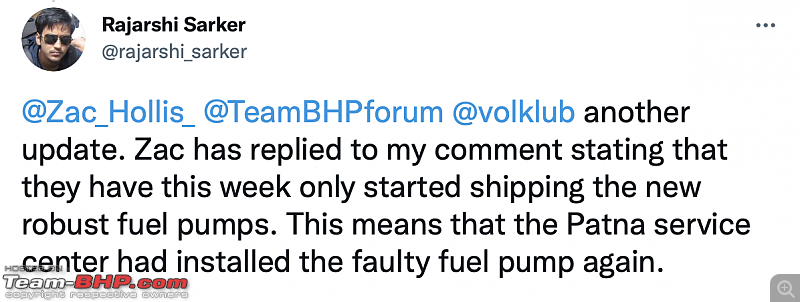

@Rajarshi - Since Zac says the pumps have started to arrive only now, Does this mean whoever received the parts replaced with supposedly Robust bits already are going to be on the side of the road again?
Kosfactor is offline
Old 18th September 2021, 22:58   #267
Join Date: Jul 2017
Posts: 21
Thanked: 70 Times
Re: Skoda Kushaq breakdowns & problems
Exactly my point KosFactor. If you don't have a resolution, don't do a dirty fix and just hand over the car. People just can't have their car towed multiple times because of the same issue when apparently they have been told that their issue has been rectified. The issue in question right now does not categorize itself as a niggle but as primary breakdown parameter.
