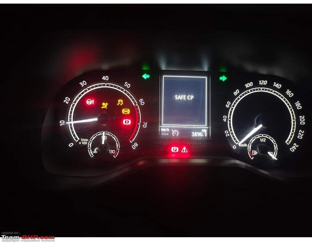

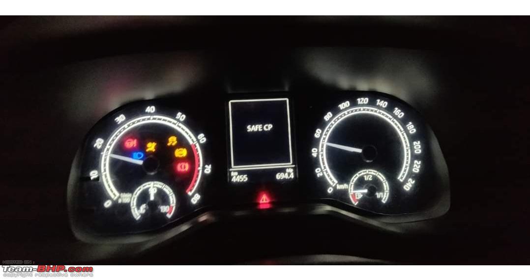

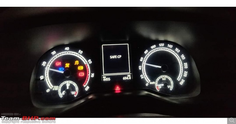

But recently there seems to be a new common error of component protection getting enabled. Wonder what is triggering this, though looks like the dealerships might be doing a simple reset to fix it for now. Is this "Safe CP" some sort of 'limp mode'?
Internet says it indicates a fault in the electrical systems/accesories like ICE but someone mentioned some BCM issue could cause it as well.
Haven't reseached much but seems unrelated to the EPC/Fuel pump issue or could be if there was an update for the EPC which caused this. Can't say, equal probability of both.
