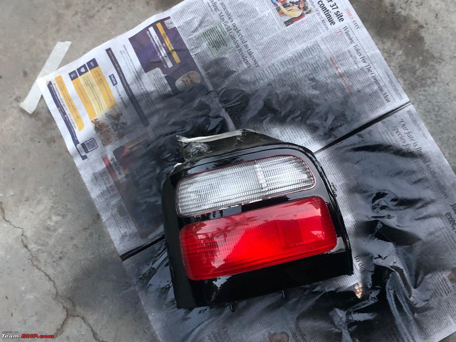

Thanks!! Wow! even you had the same color and model, quite rare! Also yes I have done a paint correction and I've done some cosmetic changes to the tail lights. Keeping the steel wheels though.
Restoring my dad's old car | 1999 Maruti ZEN-LX-8d0bf0425cee41f3bbec60e977514443.jpg
Restoring my dad's old car | 1999 Maruti ZEN-LX-fcb92df536a94767bae0076fd914b443.jpg
