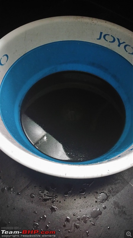

Got down to cleaning my K&N Air filter after 19000km.
Kit used 99-5050 K&N Recharger
Time required - Approx 8 hours
1.Used the cleaner to spray on both sides of the filter; then allow to soak for 10 mins
2.Hose down the filter from the clean side back to the dirty side
3.Repeat Steps 1 and 2 till the wash water is free from dirt.
4.Allow the filter to dry naturally. In this case I dried it in the sun for approx 4 hours.
5.Oil the pleats on the filter with the recharger oil.
6.Allow the oil to soak in for 20 minutes.
7.Touch up with oil to bring a uniform pink shade back.
Lessons learnt : After 3 rounds, it would be better to soak the filter in mild detergent solution for longer to bring the filter back to its base bright white shade. Only then will the filter look bright red after it is oiled.
Now, for the pics. Look at the amount of muck this had trapped.
Am attaching a shot of the MAF sensor - no carryover dust there at all.
Dirty filter
Wash water after rounds 1 to 5
Clean & Oiled filter
