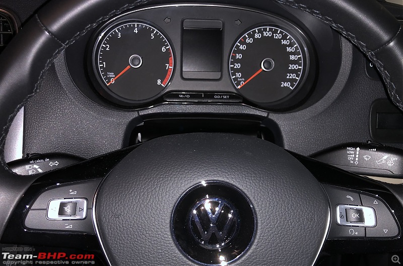

Hi, here is my Polo's steering column:
Quality lapses & fit/finish issues in my brand new VW Vento TSI AT-20220922_2017562.jpg
Quality lapses & fit/finish issues in my brand new VW Vento TSI AT-20220922_2018082.jpg
Apologies for the improper angle but the flaw is evident.

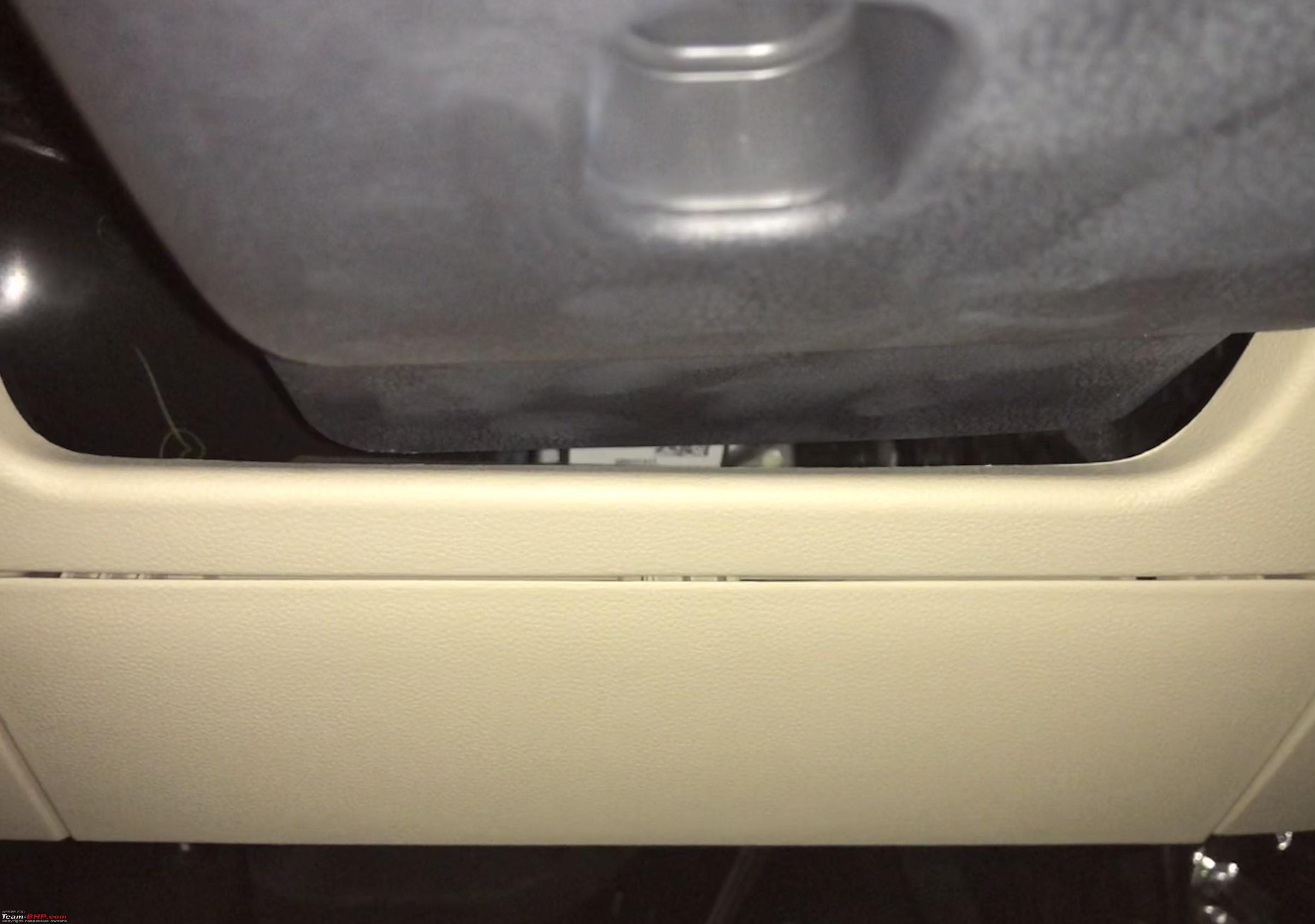

Thank you for the pictures. The flaw is evident. Let’s hope for the best and Wish you happy miles ahead !:)
In the space below the lower column cover, the flaw is clearly seen as well. FYI

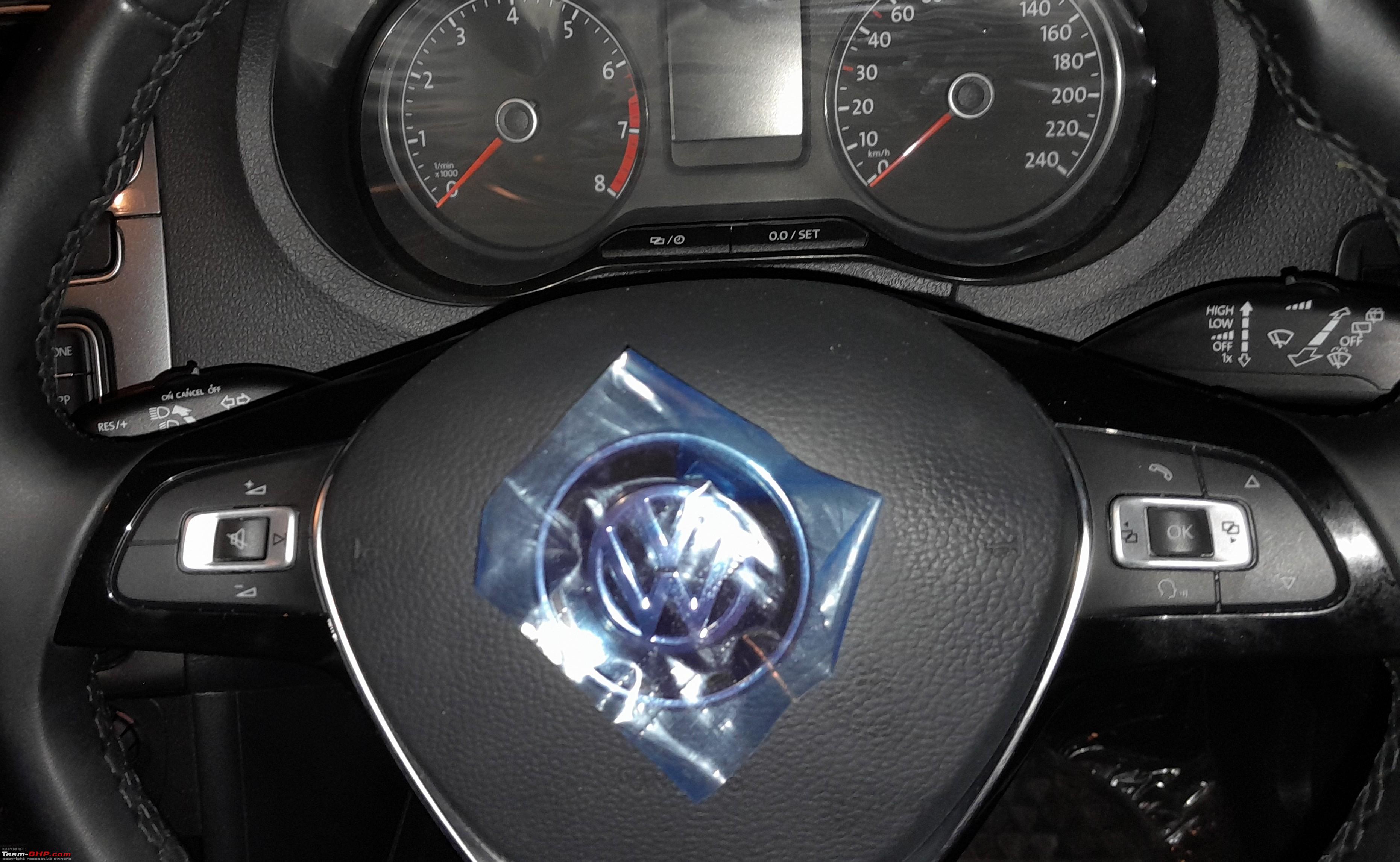

OT post : are you still having the plastic on the VW emblem on your steering wheel? If yes, requesting you to remove the same :thumbs up
Yes I still have all the plastics intact, may I know the reason for removal?:)
Simple. VW kept it like that, because it has to be removed. Else they would have laminated the emblem in a proper way. Also these plastics are of crappy quality which are kept just for one purpose only 'protect the things till the car delivery'. I don't want to derail the actual discussion here any further, you can make the final call based on your preferences. But I believe everybody here would also be suggesting you the same.

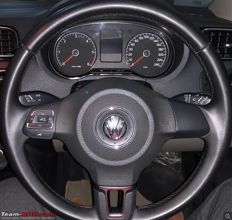

Thanks for your detailed observations! I can confirm my 2022 Polo also has this issue. I did notice it before, but I thought that's how it is designed. Did not think about it twice. But now that you have pointed this out, it definitely is an eyesore!

Hi Vedirah !
It’s an eyesore for sure. A Swift and i10 in the family have perfect alignments around the steering compartment. What I see on my Vento gives me an Ouch! each time and takes away all the fun. There are more flaws on my Vento which have been documented earlier in this thread of which you may have a look too. Probably, all this is bonus when you buy ‘about to’ phase out vehicles.
Nevertheless, kindly share images of your steering column upper cover in a straight ahead position with respect to the driver for me to understand the amount of column tilt.
I have been planning to document more number of such cases and escalate this to VW and try getting an explanation & solution from their Factory and not their dealerships.
