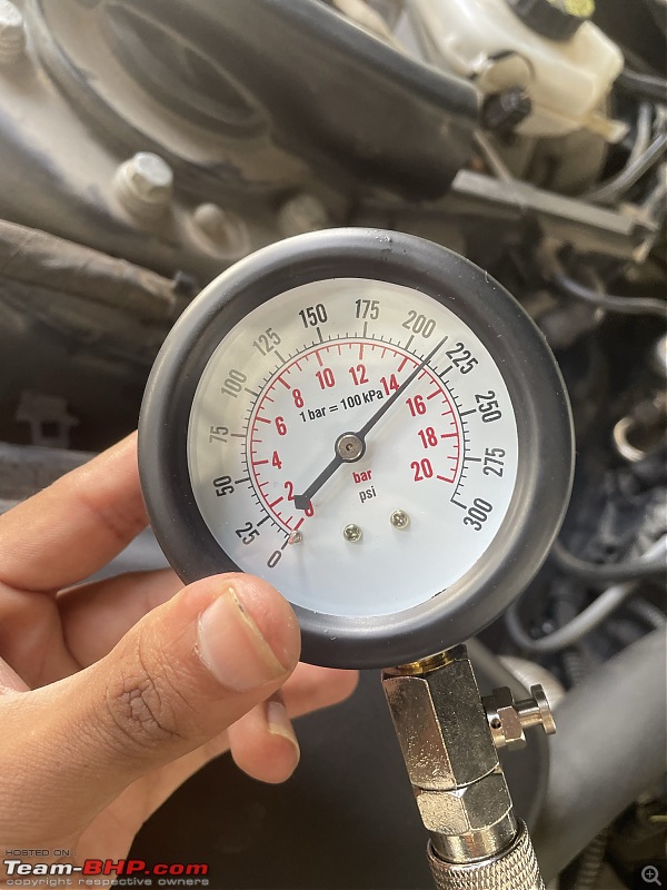

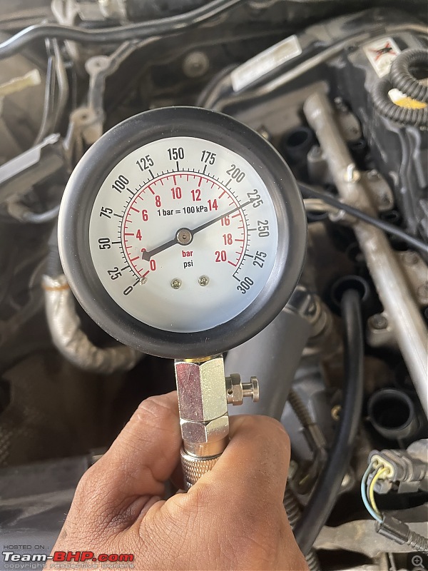

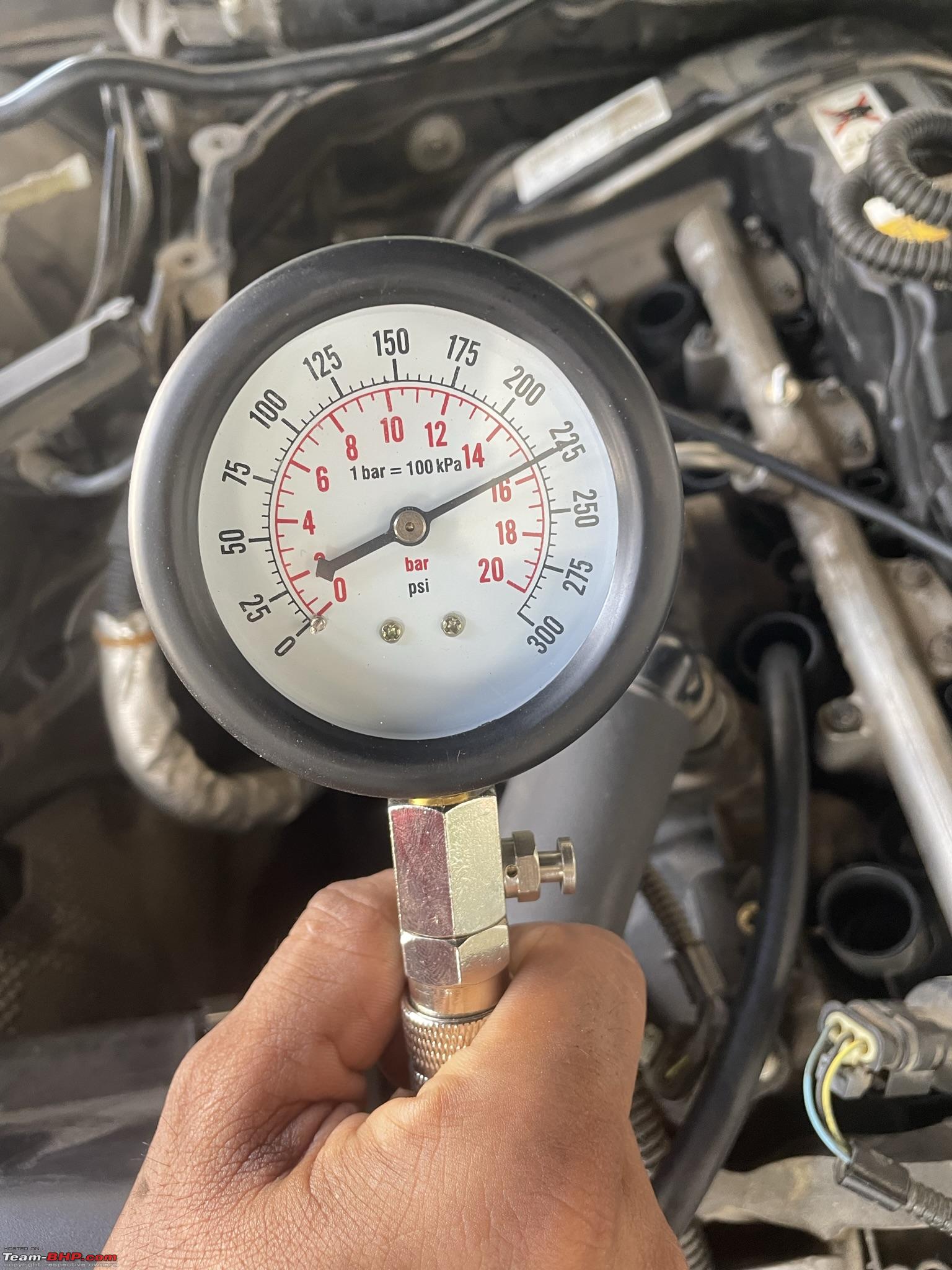

As I did not believe in their diagnosis, I went ahead and purchased a compression tester and leakdown tester from toolbuy.com. Although this costed me Rs.15000, I thought it was better than whatever BMW would do blindly opening an engine.
A compression test was performed on all 4 cylinders that showed consistent 225 psi across all 4 cylinders. I also performed a leakdown test which showed less than 5% leakage on all cylinders.
Compression Testing the Engine
Harrowing experience at BMW Jaipur and how I saved myself 10-lakhs at a FNG-img_3259.jpeg
Harrowing experience at BMW Jaipur and how I saved myself 10-lakhs at a FNG-img_3260.jpeg
Harrowing experience at BMW Jaipur and how I saved myself 10-lakhs at a FNG-img_3261.jpeg
Harrowing experience at BMW Jaipur and how I saved myself 10-lakhs at a FNG-img_3262.jpeg
With this testing, I was convinced that the engine was in a healthy condition and spoke to the dealer again. The dealer did not have a response on my findings and insisted on opening the engine.

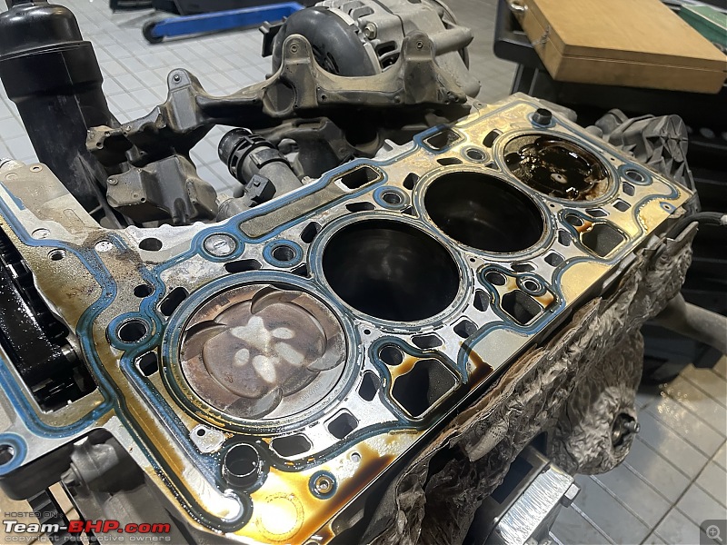

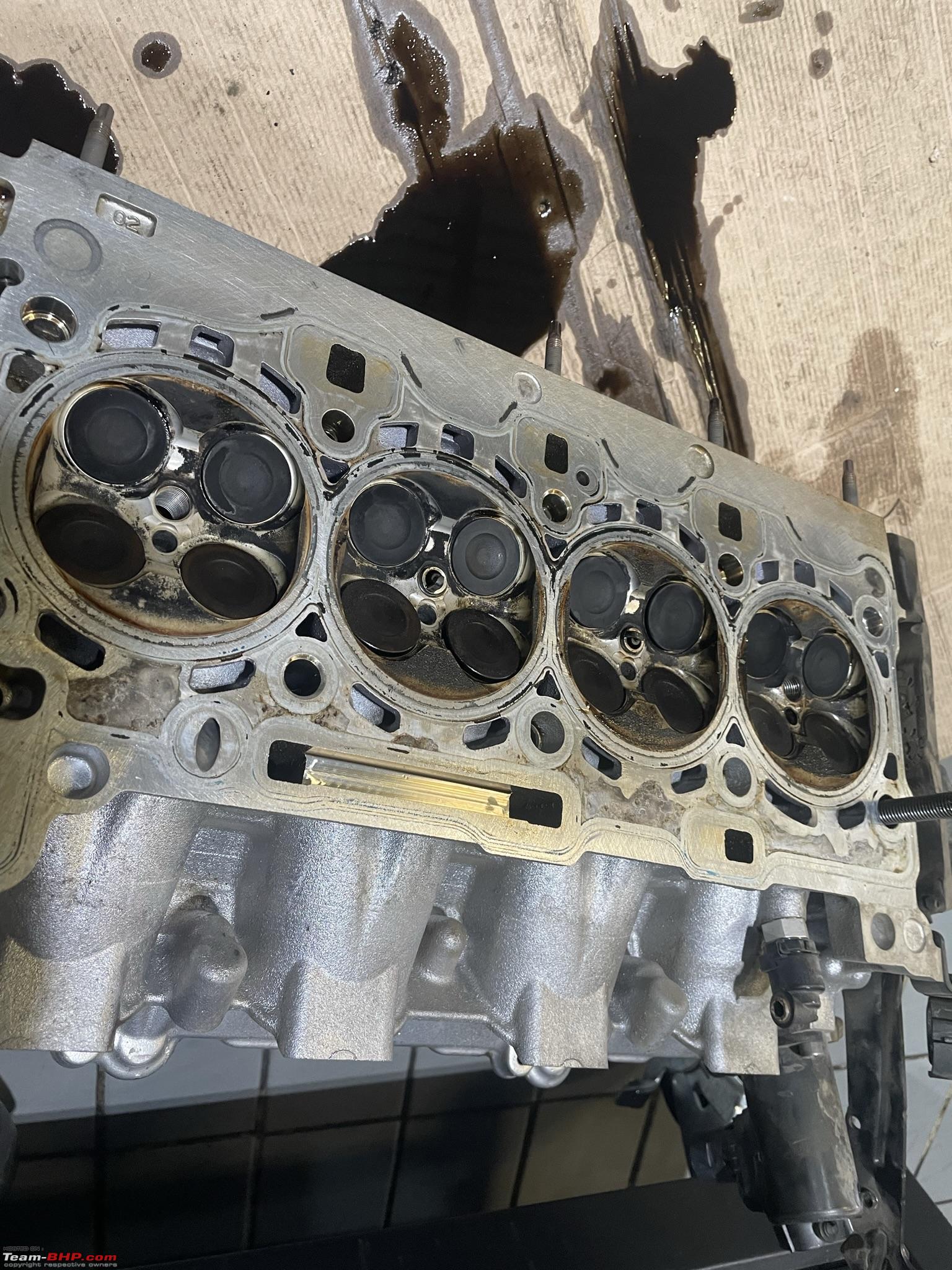

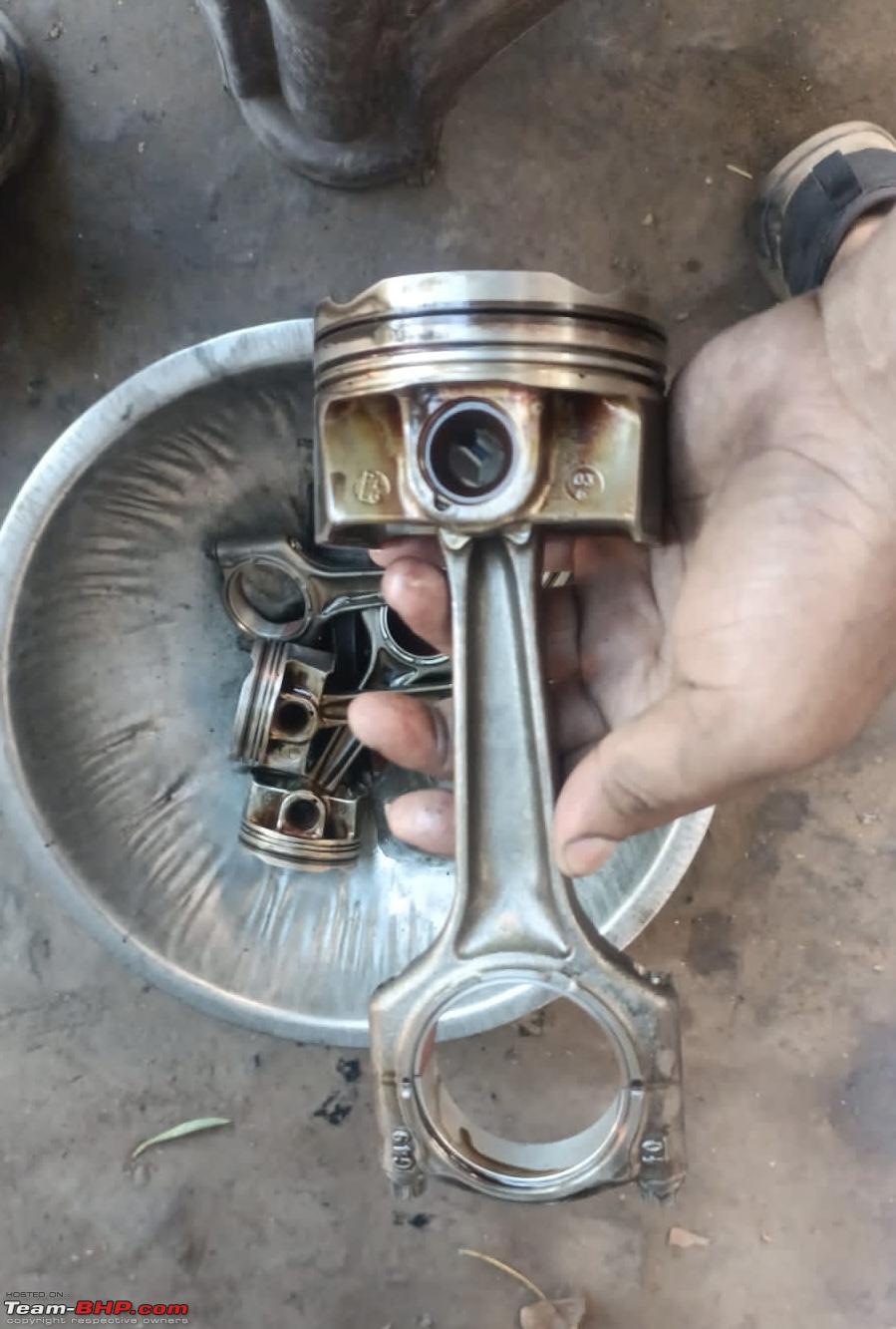

Engine Disassembly and Results - 5th March 2023
The Car was sent to the dealer, they opened the cylinder head and according to their diagnosis all cylinder bores are out of spec. They claimed that the 82mm bore of the B48 of all the 4 cylinders had somehow enlarged by a 0.02-0.03mm and that was resulting in the oil pooling. I did not believe their stories since bores do not just deform on such a well built engine. Note - The B48 block is extremely strong and has a plasma arc coating on the bores. It is built to the same standards as the widely renowned B58 and custom turbo engine setups are producing 500whp with a stock block B48. There are zero known issues with the B48/B58 block and they are only known to fail due to a significant injector failure causing detonation.
Among their many hypotheses, the technicians also suggested that the valves were damaged thus the whole engine needs to be replaced for around Rs.12,00,000. I was present at the dealership when the engine was fully dismantled and I noted that there are no visual signs of wear on any of the cylinder bores. Cylinder 2,3 and 4 are dry but cylinder 1 had oil pooling for unknown reasons. I spoke to my tuner who is a B48 specialist and he too could not find anything wrong in the pictures i shared. The oil pooling according to him was probably due to the disassembly process causing oil to spill out of places. I could not comment on the valves since I lack the experience but so many issues on a fine running engine were not possible.
Few Pictures of the Engine Disassembled
Harrowing experience at BMW Jaipur and how I saved myself 10-lakhs at a FNG-img_4540.jpeg
Harrowing experience at BMW Jaipur and how I saved myself 10-lakhs at a FNG-img_4541.jpeg
Harrowing experience at BMW Jaipur and how I saved myself 10-lakhs at a FNG-img_4548.jpeg
Harrowing experience at BMW Jaipur and how I saved myself 10-lakhs at a FNG-img_4549.jpeg
Note that cylinder 3 and 4 that had the misfires code had not even a speck of oil on them. The dealer did not have an answer for this and blamed the valves for the misfires.
Distraught by the diagnosis received, I turned to a bhpian mechanic in delhi @Viraat13 to help diagnose the issue.

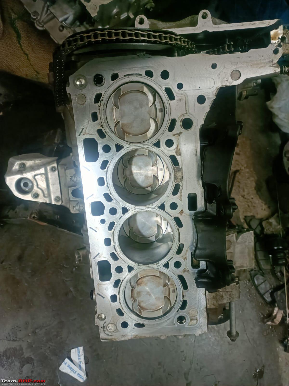

Since the engine had already been opened by BMW once and returned with the same old gaskets and loosely put together (As I requested), the engine was dismantled by Viraat again. He too did not find anything wrong with the engine per se and suggested that the piston rings and valve seals be changed just to make sure that the engine is fine. Although I was reluctant on changing either of the two parts due to the lack of any compression loss, I went ahead with his suggestion with a couple of caveats -
  1. Absolutely no honing of the cylinders - The B48/B58 cylinder bores cannot be honed and since they were in mint condition, I asked specifically for no honing to take place.
  2. The engine should be built to factory spec - I also provided Viraat with all the relevant technical literature from newtis.info for my personal satisfaction
Some Pictures from the Rebuild
Harrowing experience at BMW Jaipur and how I saved myself 10-lakhs at a FNG-d84b231e03f84915ab165dfc20b4370f.jpeg
Harrowing experience at BMW Jaipur and how I saved myself 10-lakhs at a FNG-3f91aab0a2b7470c9a9a75a33c41932c.jpg

On 19th April my car was put back together and on the road with Viraat in Delhi. It drove fine for 200 kms and the misfires came back as usual. Once again, the plugs were fouled.

The whole incident surrounding the bore diameter was a long and painful one, let me share what happened in detail.
When I first visited the workshop post disassembly, the head technician took a bore gauge and started to measure all 4 bores. He chose 82.00mm as the standard size and started to measure the different cylinders. He communicated verbally that the bore was out of spec for all cylinders and in both angles of measurement but never took any of the readings in writing. After I returned from the dealership, I did some digging and found these specs on the workshop manuals for my car, and communicated the same to Viraat, my tuner and Mechanix automotive with pictures of the bore. There was no possible way for my bore to be out of spec with zero signs of wear.
Harrowing experience at BMW Jaipur and how I saved myself 10-lakhs at a FNG-bore.jpg
The same communication was done verbally again with BMW India's representative. Here's the email after -
Harrowing experience at BMW Jaipur and how I saved myself 10-lakhs at a FNG-screenshot-20230603-074910.png
The injector test readings were never shared with me. Despite me specifically pointing out that the injectors need to be tested as I received an inconclusive injector test result from ISTA.
Did he use standard-size rings or over
Standard rings as found in the B48B20A engine were used. There was no need to go oversized at all on a mint bore and piston. Here is the part used -
Harrowing experience at BMW Jaipur and how I saved myself 10-lakhs at a FNG-rings-1.jpg
Harrowing experience at BMW Jaipur and how I saved myself 10-lakhs at a FNG-rings.jpg
So, per my understanding from whatever you have mentioned, had the BMW dealership done a proper compression check and had got the injectors checked, this ordeal of opening a perfect engine and everything could have been avoided?
If that's correct, then absolutely wrong on the dealership and also, the manufacturer should have helped the dealer with steps to find the exact issue step by step, instead of simply suggesting to go with dealership finding i.e a change of the engine.
I will share the link to this thread with someone and update you if I hear back.
Yes exactly, these are the compression test numbers given to me by BMW.
Harrowing experience at BMW Jaipur and how I saved myself 10-lakhs at a FNG-capture.jpg
Note that the 12.5-14bar readings are well within spec. According to the service advisor, the compression readings were high thus requiring the engine to be opened Never have I ever heard the compression test readings being high as an issue. Tells you what I was dealing with in terms of technical knowledge. These absurd statements made me question every single statement by the dealership personnel during this entire endeavor. Some of their other blunders during this repair included -
