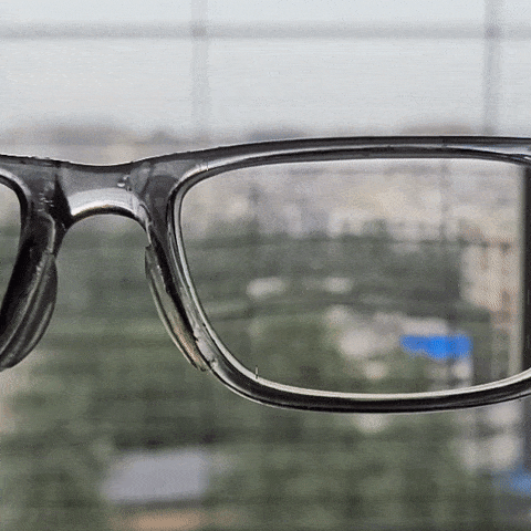

Originally Posted by dipdawiz View Post
... Then they used clay to clean the windshield, this time the distortion was clearly visible to naked eyes. They changed the windshield again, this time it is fine. To OP, was it Saint-Gobain windshield in Seltos?
Here is a gif of first replaced windshield (look at the area near irvm)
Attachment 2504283
Kia Seltos windshield distortion is causing me extreme eye strain-20201105_123422_1.jpg
So one day I went out to our parking and did a small experiment. Not a scientific one, it is more of an observation. Also all cars were parked in different location, so reflection of different object was checked. But checked the distortion based on reflection on the windshield. And distortion means the reflection is shrunk or expanded while changing your glance; not just curved reflection. At least 90% of Kia Seltos and Hyundai Creta has some sort of distortion in "blue" area, very insignificant area plus it is behind IRVM, nothing to notice and complaining about it is sort of nitpicking. Around 40-50% of them has distortion in "orange" area however its out of direct line of sight for most of us from driver seat. And though there were not many new cars (2022-2023 batch), but many of them have some distortion in "red" area. Unfortunately one or two we found has distortion in green area (like my friends Creta or OP's seltos), or somewhere in middle or lower middle, which comes in direct line of sight and cause issue. Not surprisingly all of them are Saint Gobain and more prominent issues are in newer lot of cars (2022~2023, Seltos and Creta). And I can confirm in newer Seltos test drive vehicle I drove couple of days ago had distortion 3-4 inch in "red" area across windshield. Checked Sonet and Carens there is no visible distortion, and guess what, these set of windshields are made by AIS.
Also checked some other brands of cars and none of them has any distortion issue as such. Could have curved reflection but not shrunk or expanded. But some wavy reflection behind IRVM is not uncommon.
Now I am not expert, some of it (like the blue area, behind IRVM) could be due to the curve of the glass itself in these models and many others we saw. But looks like newer Seltos and Creta only has more prominent distortion in various area and could be due to QC issue for couple of batches or may be that much of quality only they are maintaining now.

Just to check we are talking of same effect: is this video/a.gif showing the subject distortion ?
