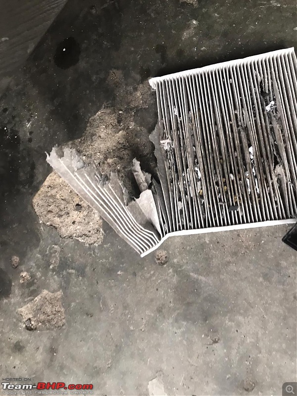

Rat damage to cars | Protection, solutions & advice-whatsapp-image-20200616-5.06.34-pm-1.jpeg
Rat damage to cars | Protection, solutions & advice-whatsapp-image-20200616-5.06.34-pm.jpeg
Rat damage to cars | Protection, solutions & advice-whatsapp-image-20200616-5.06.35-pm.jpeg
It has damaged A/C filter. Had made settlement in air filter and damaged the
entry. Luckily the before filter else would have damaged the engine.
Entered through a/c vent and eaten lot of fabric padding at the peddle. This is indeed too much mess.
