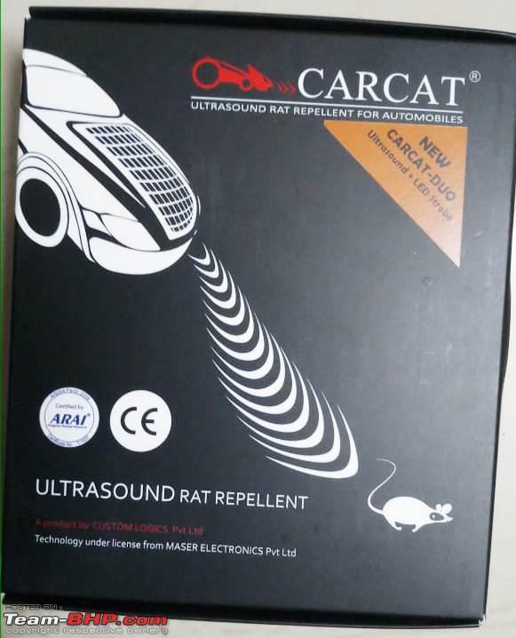

Hello Guys.
Rats are real problem. In my previous car I have used rat repellent spray at the engine bay to prevent rats from chewing wires. But after few odd months it became ineffective as I have found multiple chewed wires which had to replace.
While purchasing new car, I have decided to do something about it and after searching over the internet, I have found a product called - Carcat, a device which uses ultrasound to repel rats. I have purchased it from Amazon and using it since last 2 months. It seems that the device is working.
I shall update after few months.

Old 7th March 2020, 22:21   #1458
Join Date: Mar 2020
Location: BANGALORE
Posts: 2
Thanked: Once
re: Rat damage to cars | Protection, solutions & advice
This is my first post in this forum and unfortunately it's about rat menace. My brand new ecosport (3 months old) was showing airbag warning in the dashboard display. So I gave it to the showroom clubbing this problem with first service. The showroom confirmed that rats have chewed a few wires. They have replaced the damaged wire sets which have costed me approximately 1.9k. They told me that they gave me some discount, though I'm not sure how much.
I stay in a rented house in BLR and the parking is in a vacant plot next to the house. There are regularly 5-6 cars parked in this plot. I'm yet to check with others if they are facing the same issue. I have noticed rats of different sizes in and around the parking plot. Since I don't have any alternative parking place available, I'm planning to buy some roddent repellent spray online to test my luck. I'm not sure if I should spend a bigger amount in buying roddent repelling ultrasound devices as the responses in this thread are mixed!
I'll update this thread about my experiences with the spray after using it for awhile. Keeping fingers crossed!
In the meantime if anyone comes across any solution, please keep us posted.
