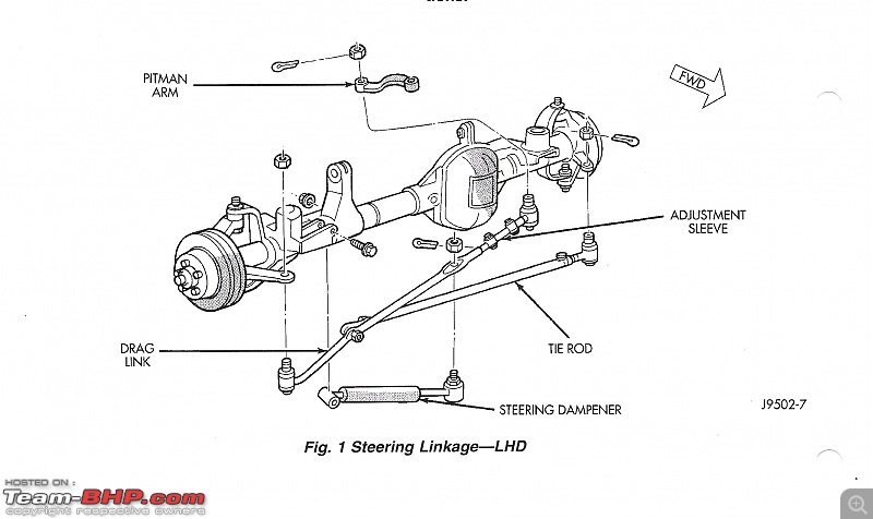

So far I have always dealt with external dampers. Here you see the old and the new one for my W123 I replaced last year I think.
Baleno steering loses recentering function after service from Indus Bharanikavu, Kollam, Kerala-screenshot-20231118-4.03.17-pm.png
I have also replaced the damper on my Jeep recently:
Baleno steering loses recentering function after service from Indus Bharanikavu, Kollam, Kerala-mini-optionsexpertisebureau-1.jpeg
Just a note on making the final adjustment on any steering box. Always and I mean always go by the book and with the tools prescribed in the book. By book I mean workshop manual or specification. It is impossible to adjust a steering box properly by feel and or sound. It might feel and sound right, but unless you have managed to get the play and tolerance set up in accordance with the exact specification you are likely to see wear again and more quickly than the previous time.
Ask me how I know.
But it is very unlikely these type of steering arrangments become more stiff over time. They tend to become looser over time, due to play and the internal bushings wearing down and providing less friction, start leaking and so. Also, there is no mention by the OP of any work carried out on the steering box. But an alignment was carried out and the problem appeared.
Maybe they did fiddle with the steering box settings? Maybe it was a bit loose and they tightened it prior to the alignment, that could definitely happen. It is impossible to do a correct alignment with play in any of the suspension and or steering components. Can't be done, so you need to fix/adjust that first!
Lets see.
Nice job on the steering rack overhaul by the way!!
Jeroen
