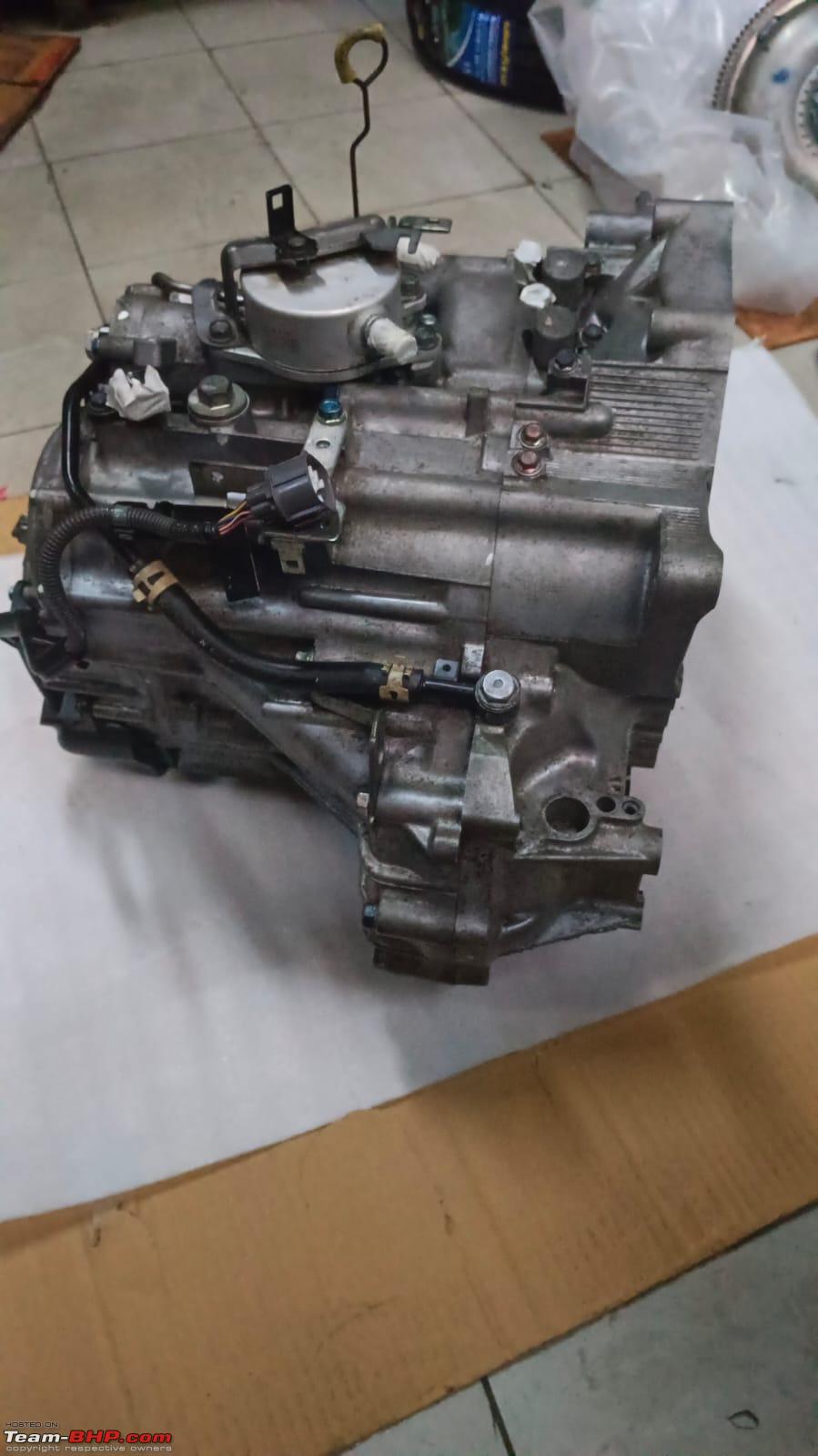

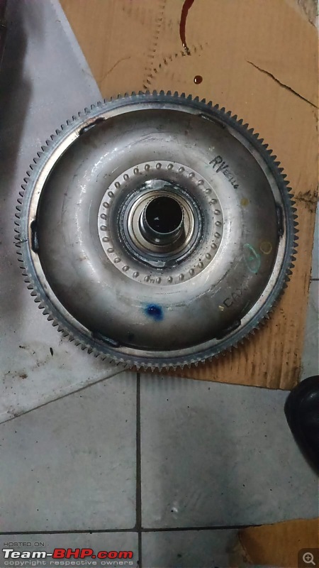

Hey everyone, A quick update.
I just recieved pictures of the transmission and torque converter offered by honda and i’m not feeling too optimistic about them. The torque converter looks fine but the transmission seems used. Maybe someone with more experience can weigh in here and give me an opinion. My dad isn’t happy based on what he’s seeing. I think the torque converter looks good and at 50 percent off could be a great way to Frankenstein the rebuild from sehmbi. Please let me know what you think. Thanks.

Both the components are used, make no mistake. Seems to me like they had someone come in with a failed trans and the dealership went scouting to the scrap market. How generous of them! And to think they're offering these to you at 50% of the new price - how kind! Such a dependable service center. /s
It's more crucial than ever at this point to open up the trans and perform a root cause analysis. Only once you know what's wrong should you make ANY purchases. It could be that the TC isn't even at fault.

Yeah this is unbelievable I genuinely can’t believe they were trying to trick me, they even sent the picture in full confidence. Incredible. What thoughts do you have on the integrity of this used set of trans and tc, if i call them out and get it for dirt cheap say under a lakh or maybe even lower would it be a feasible option? Or should I continue with the rebuild like you said and have them tell me what components have failed. They have told me i’ll have a diagnosis by them by tomorrow evening as they are still testing the car. I hope the TC is still good as it will majorly simplify things.

This would’ve been the way to go, but if you notice the pictures in the update, the transmission parts honda is offering are very clearly used. I don’t know how to get a history on them. I will lowball the heck out of honda now that I’ve seen these are used parts. If they come down on the price significantly it’ll be a matter of rebuild vs used parts.

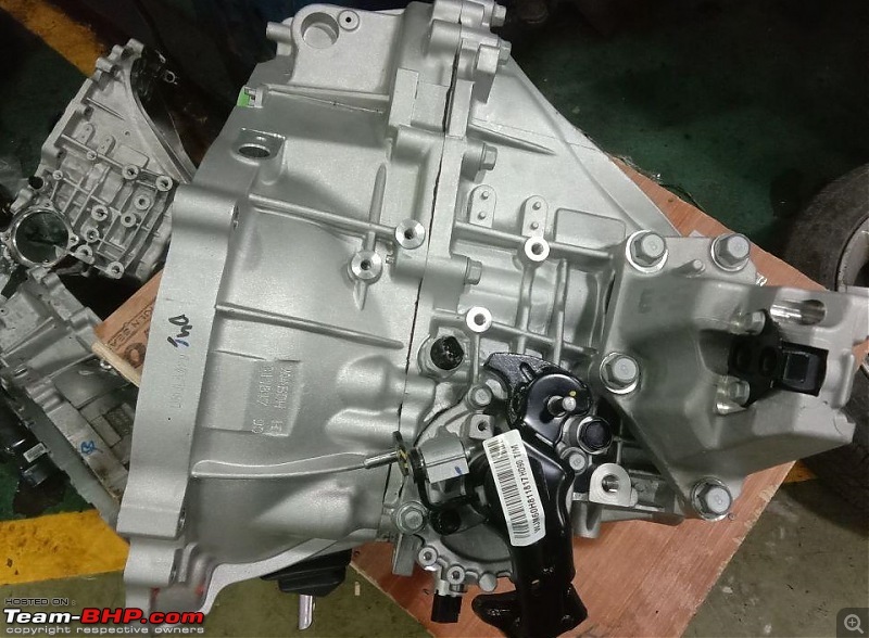

Did they confirm if this is a used tranny or new one? This is what a brand new gear box from the factory should look like. This is a Hyundai Verna replacement gearbox for a bad manual transmission.
Now we know why there's a 50% discount. The dealership probably got it from the scrap market dirt cheap. Maybe push or more discount citing that this is an old box and you don't know how much KMS it has been used for. Alternatively you could try and source a transmission from a totaled/scrapped accord and have the dealership install it for you.

I still can't believe Honda ASC is offering customers used/scavenged parts and asking 50% money. Which Honda ASC is this?
If it was a brand-new part, going with Honda ASC would have made sense with this 50% offer. With Honda, customers can be better assured of the technician's knowledge/abilities and their tools. However, in this case of getting used parts, if there are issues post repair, I dont think Honda ASC will warrant it rather they will ask customer to bear any damages and costs.
