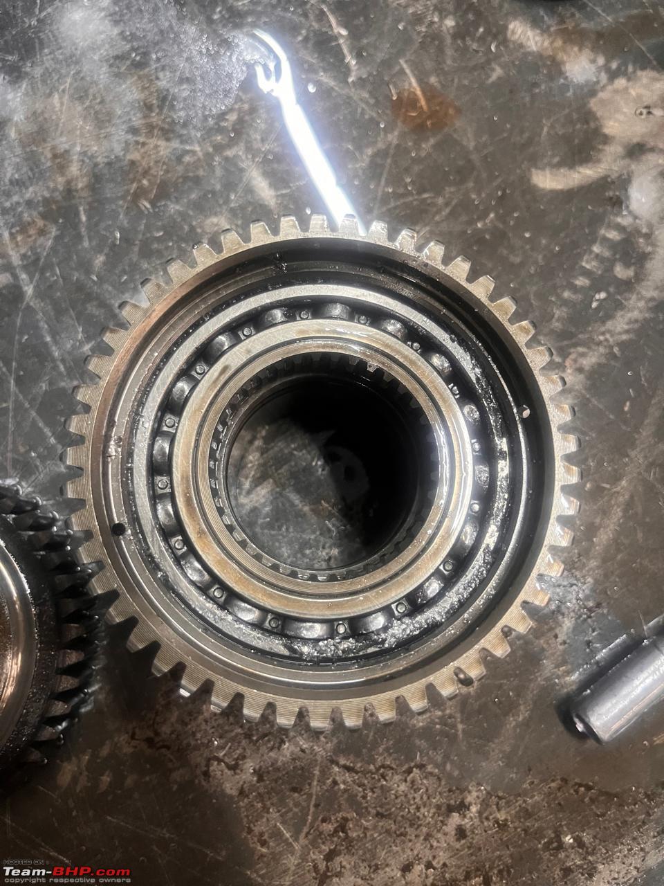

Interesting information, however this doubt has been cleared since they opened up the transmission and found bearing material and a broken C clip along with a broken one way gear. I’ll attach the pictures here so you can see, and, the people of the community can give some input. I’m hoping the torque converter is safe as I have heard that they rarely ever fail and the team at SEHMBI said that the torque converter is not damaged to their knowledge.
Attachment 2733756
Attachment 2733757
Attachment 2733758
Attachment 2733759
Ah yes, looking at the pictures, this seems to be the exact same issue that's mentioned on the TSB and my comments above. You can see that the outer stabilizer rings of the shaft bearing is pretty much disintegrated. This is pretty much what gets 90% of all the V6 Accords of this generation and is a well known issue at Honda.

The Torque Converters are usually rarely damaged, the weakest point of failure on these Hondamatic Transmissions is the bearing stabilizer rings. They had very little clearance and were not built to spec so they disintegrate, particularly happens with the second gear shaft. The damage is usually catastrophic since bits and pieces of the journal clog up the transmission solenoids however, it can be rebuilt.

Yep, that's the same bearing sleeve rings I've mentioned in my previous comment. It surprised the folks at SEHMBI since this is usually an uncommon failures on transmissions but it is the cause of 90% of 7th Accord V6 transmission failures. It was a design flaw from Honda's part, of which they did give out quite a few replacements for free overseas. And yeah, while you're this deep in, it makes sense to of course change the clutch packs.

Actually, interestingly enough, the death of my transmission was completely sudden like a flip of a switch.
Well, again, this is expected. Those bearing are subjected to constant wear and when the outer rings (eventually) break, they give up in an instant and stop transmitting the power. And the shaft bearing centers the next gear shaft so without the power being transmitted to the journal, it's impossible for the transmission to shift gears and this happens in an instant since the bearings pretty much disintegrate.
But I'm surprised how you didn't see any signs of the transmission failing earlier.
For these Accords, before the impending failure usually, you would have had a few warning signs.
A typical symptom of failing shaft bearings is the transmission sometimes acting like it's in neutral when on Drive and the RPMs rise for a bit before the bearings grab and it manages to engage the next gear with a bit of a vibration. This is the bearings slipping for a moment and trying to grip again and is a sure shot sign that the Hondamatic is on the verge of failure. This problem worsens as the bearing race and ring metal gets shaved off and the problem would exacerbate to a point where you'll have to come to a full stop and shift to Neutral and Drive again to have the bearings grip. Once this starts to happen, it's pretty much game over for the bearing outer shells.
From everything you have told me, it seems that the way the transmission has failed is exactly as expected for a 7th gen V6, nothing seems out of ordinary. You've encountered the textbook documented failure so rest assured that it can be fixed. If you have other troubles like a flashing D light or something else that was broken, I'd start worrying then. But since you didnt, rest easy and let the car come back in its former glory.

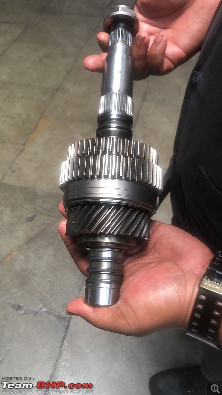

Finally, we have some movement on the Accord. I just received information from SEHMBI that the final part, which had been pending for over two months, has arrived in Bangalore. I was sent a picture, which I’ll attach below. The part looks incredible from a machining point of view—definitely looks equivalent to a factory part. The extra price I paid for this now seems justified.
I spoke to the technician at the Bangalore workshop, and he told me that most of the work on my car’s transmission is finished. They should be able to mount it back onto the car tomorrow. After a long road test to ensure everything is functioning to spec, I’ll finally be able to get my beloved car back home.
I’ll keep updating as I receive information. Fingers crossed I can pick it up this weekend.
