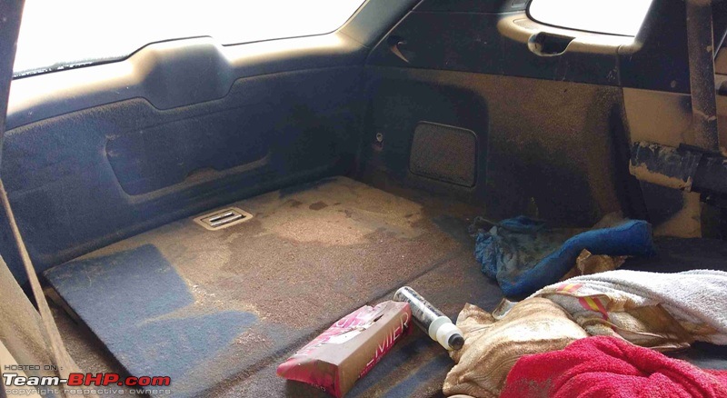

Originally Posted by hardilip (Post 4287713)
2) Should he force for total loss? (At the moment he wanted the car back with him and not thinking about total loss)
Looking at the pics, even though he may be able to salvage the car, the issues that can crop up after the restoration of a food damage vehicle is not worth it. The upkeep maybe high for this on the long run and the chance that something else going wrong is high. I think it is better to cut the losses and claim a total loss.
PS: I think it may have been better to park the car with the engine on the other end as that portion seems higher.
I think the rear of the cars have lifted up due to buoyancy and not due to elevation difference.
That car will never be the same.
You cant just wipe the dashboard or dry the carpet or seats.
Imagine kind of stuff hidden under the dash and inside the AC system or inside the door panels.
Not an accident but an automobile damaged in an accident with nature for sure.

Guys,
My 2015 red Polo GT TSI is dead. I am at a loss of words and would really appreciate some help. I seriously think the service centre is trying to fleece but I really don't know what to do. Here's what happened.
On the fateful night of July 2, I reached home safe but my by-lane was completely submerged. So I decided to find a safe parking spot in the main lane . I found a place where there was no water logging and a lot of cars were parked. Looks like overnight it rained like crazy. When I went to my car next morning to go to work, I realised the worst. The car wasn't in the position I had parked it. I opened the door and it was water everywhere. All the cubby-holes were filled with dirty water and entire floor of the car was submerged. I didn't turn the ignition on at all. AT ALL. I just switched on the battery and everything was working fine. The electric mirrors were working fine, no engine light, airbags light showed up. Simply put, nothing was wrong. But as a precaution, since I know if a car is submerged it should not be cranked, I didn't do that.
I immediately called a towing service, opened the gearbox flap, turned the gear manually to neutral and towed the car to the service centre. The service centre confirms that the engine is running fine and there is no water in it but they say the gearbox is gone and needs to be replaced. His exact words, "gearbox is jerking so we have to replace it." Then he says sensors are malfunctioning so have to be replaced. In total, he said the repair cost of the car would be around Rs 7 lakh!
I am flabbergasted. A new Polo GT TSI costs Rs 9.6 lakh. How can repair costs where enging isnt even touched cost Rs 7 lakh? Now, here things get interesting. The IDV of the car is Rs 5.5 lakh which means Tata AIG insurance is going to classify this as total loss. Unfortunately, 5 EMIs are still pending so the balance money I will get will be less than Rs 5 lakh.
The interesting bit is this: When on Saturday the service executive called and told me this, he said my car's IDV is Rs 8 lakh so I don't have to worry as insurance will cover it. I told him he was wrong that the IDV was Rs 5.5 lakh. He asked me to double-check. I asked him to double-check. Guess who was right? Me, of course.
So here's what I think. He mistook someone else's policy for mine and decided to make a bill of Rs 7 lakh to make most money possible. Now, when he realised his blunder as my car's IDV is only Rs 5.5 lakh, he is trying to cover up by saying that the estimate is Rs 4 lakh for now but as he will open the car more, this cost is going to go up to Rs 7 lakh. If I give an undertaking that I will foot the bill in lakhs after insurance pays its share, they will go ahead with the repairs else its a total loss vehicle.
I really don't know what to do at this point. I really love this car and was really looking forward to December when the EMIs were getting over and the costs of owning the car would come down drastically. I am shattered. I am just unable to understand how can repair costs of the car be Rs 7 lakh with engine excluded when the new Polo GT TSI costs Rs 9.6 lakh?
Can anyone suggest me anything? What are my options, if at all? This was my first car with my own money and I really paid through my nose to buy it. I cannot afford a new car right now and the financial loss caused by this is really spinning my head.
PS: I am in Mumbai.
