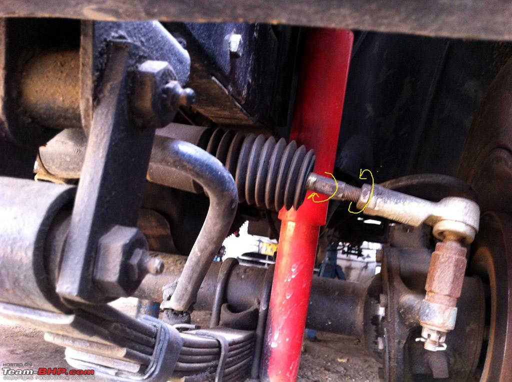

in case its misaligned how does it bring it back in place?
Most of us cars nowadays comes with rack and pinion steering, and only Toe-in and Toe-out can be corrected.
If there is a mistake, then the length of the rack is adjusted.
Here are some pics. I have marked the areas where they work upon to adjust the length of the rack, to make the wheels point straight.
Source: How a Car Steering System Works - 2CarPros
dhanushs is offline   (3) Thanks
Which means are you saying its not possible to make any caster/camber corrections on the car when they are found out of accepted values??
Well, technically, if the vehicle hasn't been in an accident or has been in some extreme off-road situations, there is no reason why the caster/camber should differ from the OE values.
In that case, what I meant is its not as easy as turning nuts and bolts, and Alignment guys will not do it. You will have to find the reason for the misalignment, and get it corrected from a workshop.
In vehicles which I have seen caster/camber values off the chart are the ones that have been in an accident and replaced/repaired Apron.
