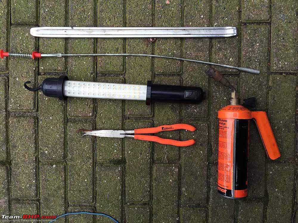

What you really need in these sort of situatino is one of these little grabbers>
Shown here just under the tire lever. Very handy to pick up things where you can't reacht them:
Good luck
Jeroen
