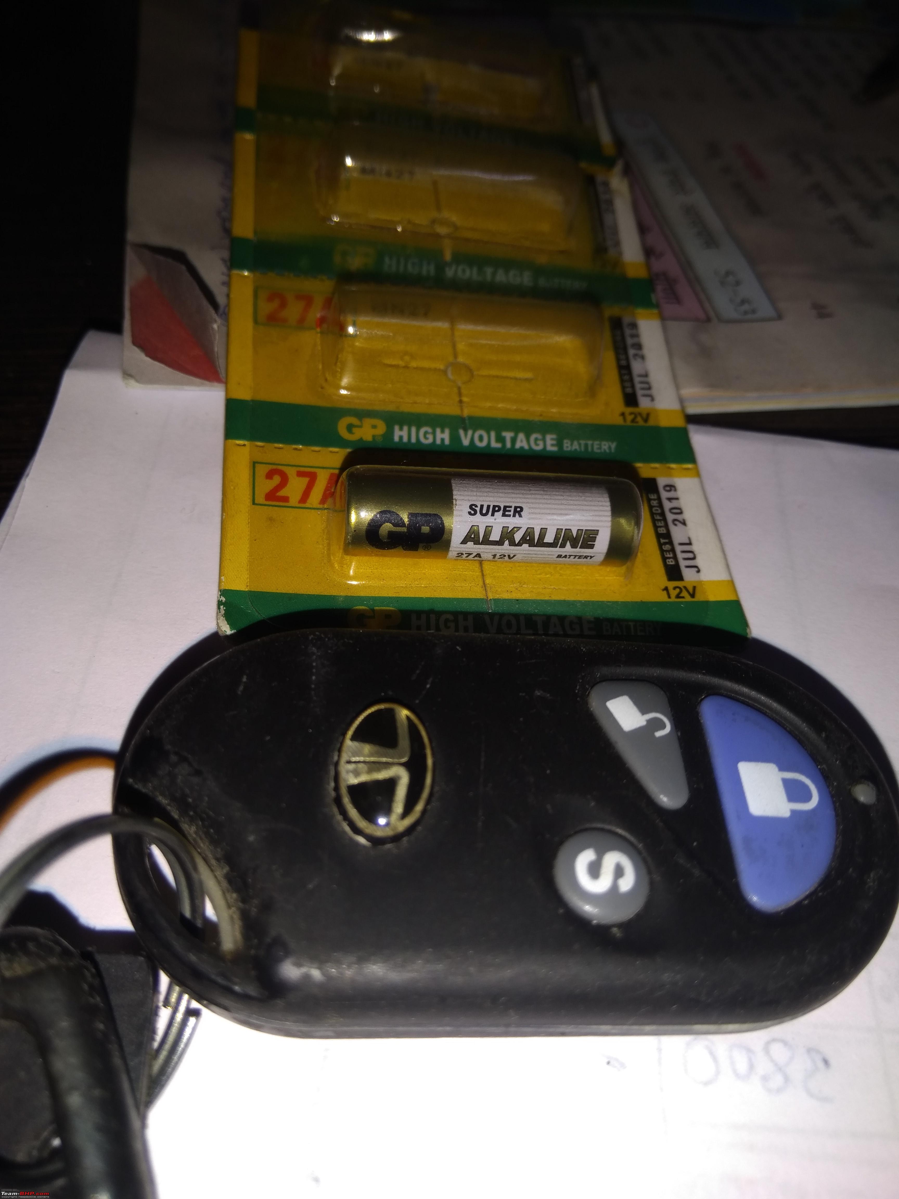

Lucky you, if your remote(s) lasted so long. I have already replaced 3 till now because of complete circuit failure of the earlier once. Have you tried replacing the batteries. I was told that these remotes lose their capacity to send signals to a longer range over a period of time due to weak batteries.
Look out for GP27 batteries and try to replace the one in your remote. Pic attached.The Tata Safari 2.2L Technical / Problems Thread-15633554482271214089411313902576.jpg

Originally Posted by saurabh2711 (Post 4622410)
Look out for GP27 batteries and try to replace the one in your remote. Pic attached..
A note about 27A and other lithium batteries. These are available in bulk from China. The price ranges from 30 cents a battery to 10 cents a battery, with almost all "accessory" shops importing the 10 cents type.
I would say just order from ebay/Aliexpress from sellers who have sold large numbers before your battery dies
Everyone should get them when you buy your car
5 batteries cost less than 3$ including shipping which is about 40rs/battery
