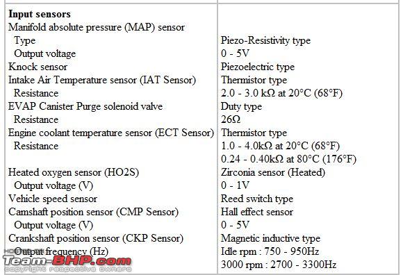

Still, for the O2 sensors, what voltage range am I looking at, and how can they possibly be cleaned?
From the service manual it appears to be 0-1V.

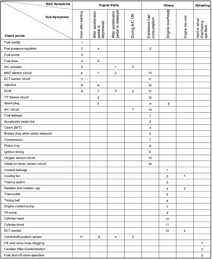

There is no guidance on sensor cleaning. However do refer the following trouble shooting guides to get a better understanding of the step by step process as recommended by Hyundai.
