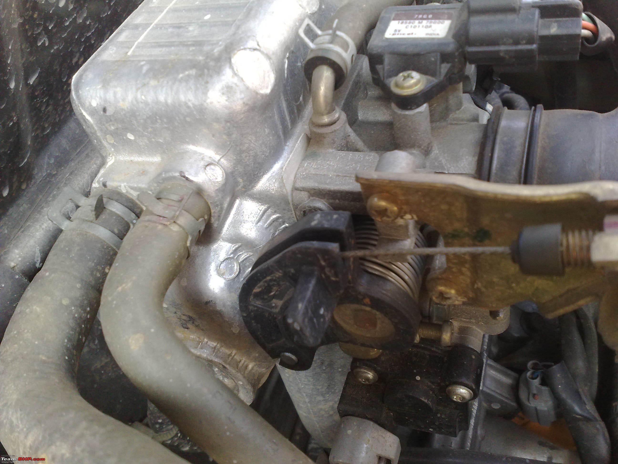

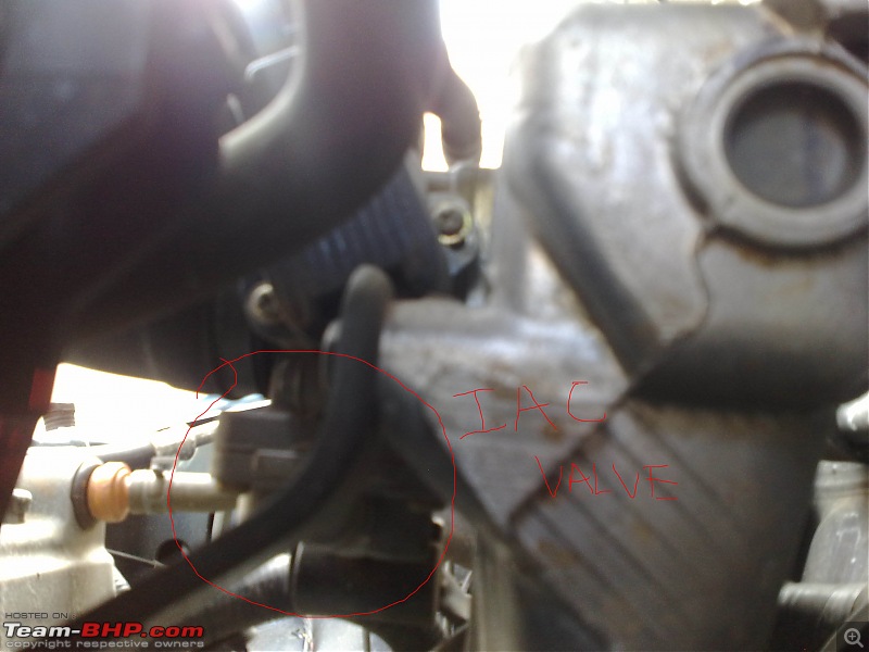

@ amit : i have posted some pics of the IAC valve in response to your PM regarding a hose connected to the IAC valve.i hope this helps.
The IAC valve(i guess) :
Bottom of IAC valve :
now i am really wondering how my alto has 2 outlets below the IAC valve. mine is EURO II model. if you refer to the 2nd picture, below the IAC valve there is not outlet pipe or any provision. it seems to be sealed. on my alto there is a outlet pipe which suggests that there should be some connection to it. but the connection is broken/missing on mine ( i suspect this ) as today i saw an alto in the garrage who has a pipe leading from somewhere to the IAC valve bottom.
Well, my bro's alto(to which the pics belong to) is a 2007 model. Anyways, i ll try to take a better pics showing the bottom of the IAC valve completely.
Speaking of hoses reminds me of vacuum. Check if there is any vacuum leak in the hoses that connect to the FPR.
Also ask the service guys about the hose that you have seen in other cars.
asked about the pipe to the service guys, they said that that used to be there in euro I altos which had coolant circuit, in EuroII there is just provision for connection but no hose pipes, and in EURO III there is no hole for pipe at all. will post the pics as soon as i get them
