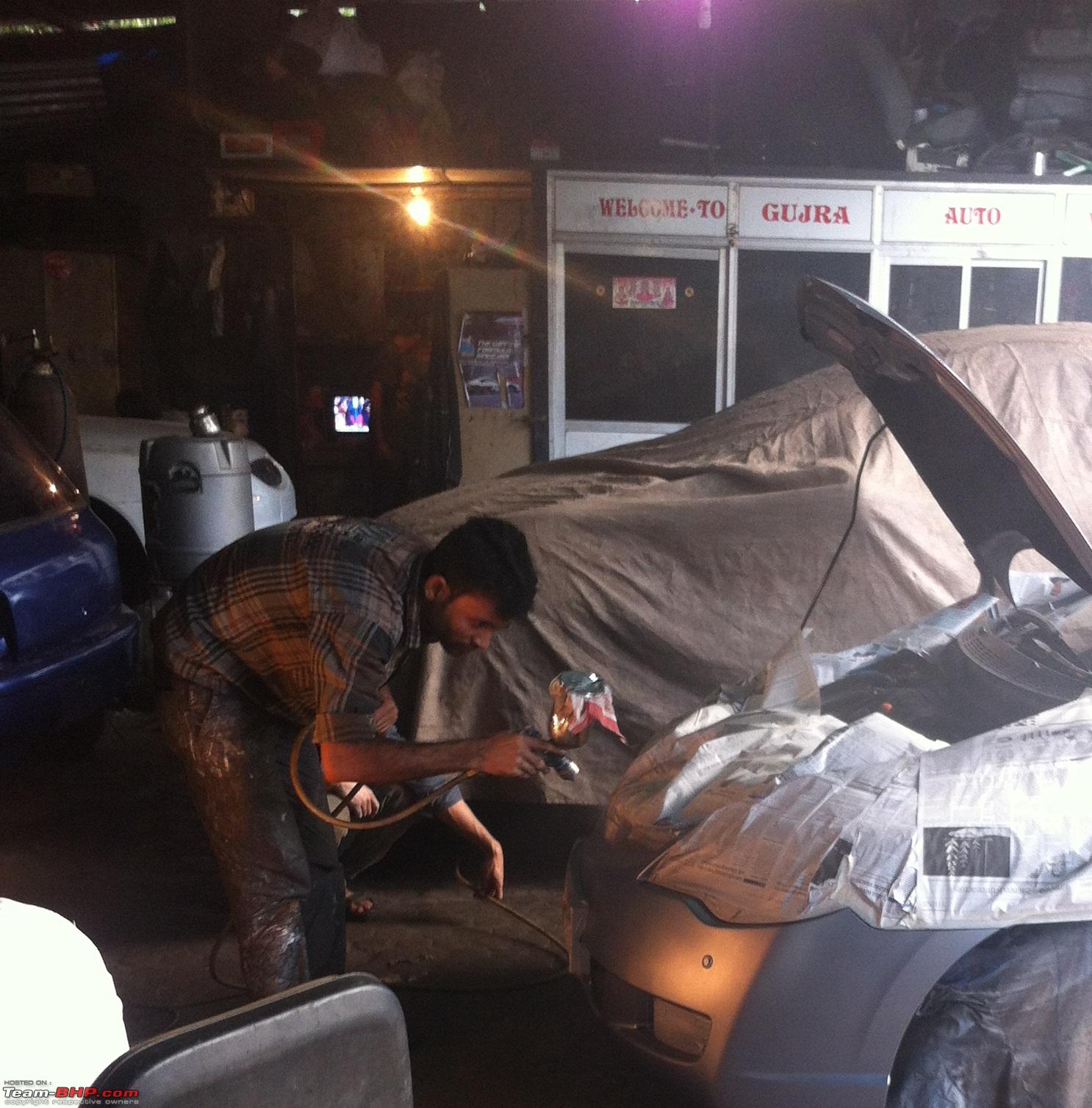

Continuing to my above post, I elaborate Issue 1:
"Front Bumper Scratch Removal ":
I happen to park in a squeezed zone at a Movie hall, and was completely relying upon the parking guy at night. I did not realize that I scratched it bad untill the parking guy asked me to halt. I wish he warned me ahead. Anyways you will see the damage it incurred.
I took it to a Garage in Kalina, Mumbai (Gujra Auto Service) to get it done nice and clean. I dont know why I choose to go there but I see these guys fixing something or the other in Audi/BMW etc. So I thought they might be experts in what they do. Please refer the representations I have attached.
It was job well done as you see but after a week driving in rains, I spotted a paint burst spot. So I took the car back to the garage as I remember the owner giving me a 3 Month Guarantee. I am shocked to see what lies ahead of me. See the picture. I was asked to come back a week later as he is under a legal scan of BMC.
Now All I do is wait, any suggestions welcome.
