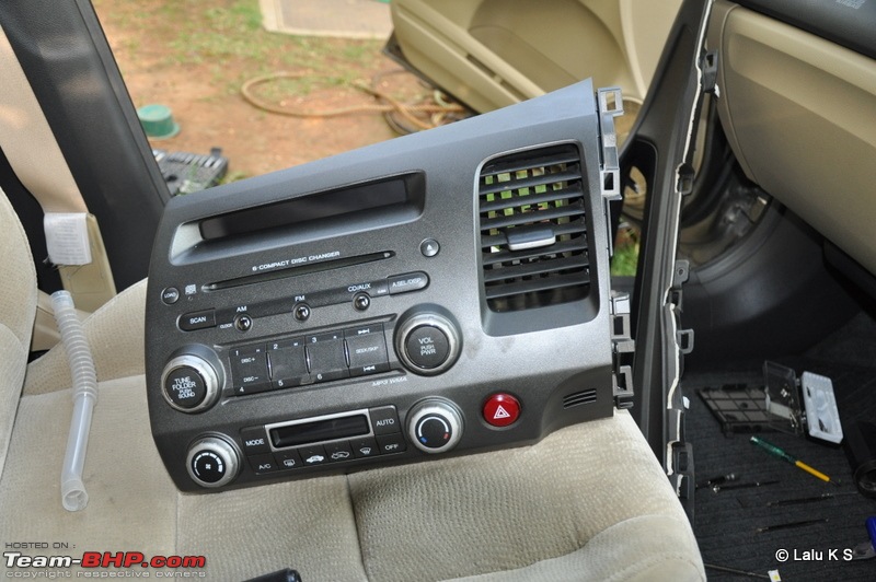

I took care of that silly rattle inside the dash by myself. Thank you ST7677 for the information on how to do it.
Some pictures from myside - how I fixed the rattle :D.

I also had a peculiar issue with the AC. The driver side vents were not giving me cool air, but the passenger sides were. While I opened the dash I understood that accessing the AC parts required quite a lot of removal of the dash. This I thought was better left with the specialists.
Told the HASS - Dakshin Honda about my AC issue, with a strict warning that any rattles after the Dash refitment I'll take them to task. This time I was equipped with all data required. Knowing me I was assigned the good guys for the job, and the only request from their side was time. I was ok with that genuine request and I wanted in return access to the car whenever I wanted to inspect. Agreement done and car given.

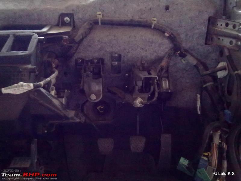

Day 3
The gear cable assembly
Honda Civic : Maintenance, Service Costs and Must dos-dscn0205.jpg
Absolutely nothing under the dash. You can see the ac piping too.
Honda Civic : Maintenance, Service Costs and Must dos-dscn0215.jpg

Took 4 working days to remove the dash, clean the ac vents, and blower and the ac inlet outlet cleaning and refitting. Very nicely done, and in each stage I was informed about the progress and I visited them daily. Absolutely fine workmanship.
