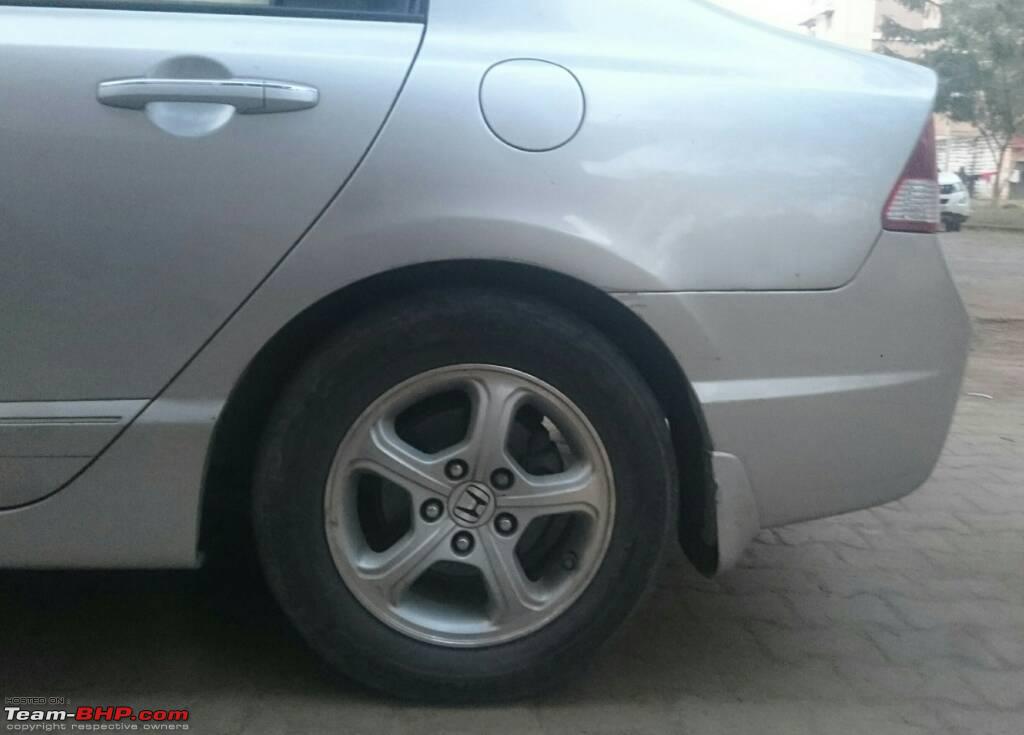

Quick update on my suspension issue: after getting front and rear coils replaced, I noticed the rear suspension had bottomed out. Tyres were hitting the wheel arches. We hadn't had the shockers replaced till now, so the brushes had worn out. On recommendation of one of my neighbors, I visited a shop in Palika Bhavan, B1. This guy is well trained on Honda suspensions and I immediately got a pair refurbished shockers for 3000/- (incl. labour charges).
There is a drastic improvement in ride and handling. Also, the car doesn't scrape anywhere. The guy recommended another modification:
A synthetic coil in addition to the metal ones installed. He claims that it'll raise the height just enough to overcome any speed breaker. He also claimed that a lot of Civic owners go for this mod. Has anyone here given this a try? My key concern is the safety and reliability of such a set up.
Another thing I noticed is that the rhs gap in wheel arches is a bit lesser than Lhs. The mechanic said this is characteristic to the Civic. Is that true?
I think what he means by synthetic coil is Rogerabs. If it's that you can easily go ahead. I am using it in mine.
Now for the wheel arch gap, this is interesting. I have the same and I was looking to change the rear springs. Never heard of this being a characteristic. Other's can confirm maybe after checking their cars.

Civic's front left and right shocks are of different capacity, but rear both are same as far as I know.
Regardless, the arch gap should not be different.
For rear wheel arch gap, it's typically around 3+ fingers gap
