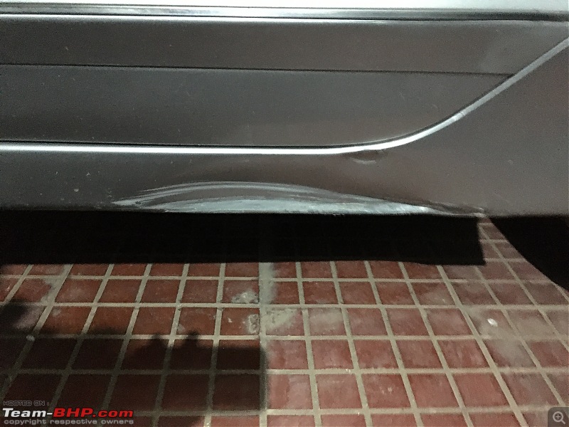

Misjudged a curb in a parking lot and got hit on the running board :( Unfortunately requires some denting.
Honda Civic : Maintenance, Service Costs and Must dos-b1588bb8f3a44b4abc4ff4cfd2fff904.jpeg
Got it repaired at an FNG yesterday. Ideally would have taken one day but since it almost started raining later in the day (and became cold), the paint job was completed next day. Paint match is good. Unfortunately, the dent wasn’t taken out completely, so they did use some fillers and putty as Cutting/ drilling holes on the running board was something I wanted to avoid.

Thanks for sharing. Looks like a relatively fine job. Was wondering what the damages would be for fixing a gash like that at an FNG?
Yes, the paint quality and match is good. So is the finish. Though, some good amount of filler was used but that was done to avoid making holes or cutting metal sheet. They asked for 3K, I negotiated to 2.5K. There was a small dent in the front side of the running board too, which was addressed as well. Obviously, the entire running board was painted.
